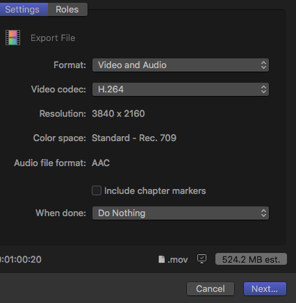

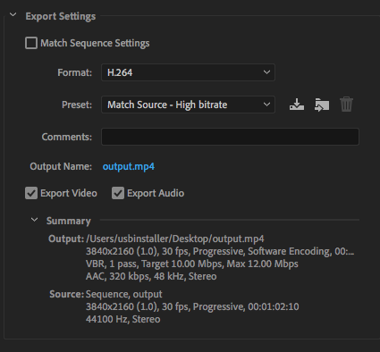

Hello,
I currently have a EVGA Geforce GTX 680 GPU and final cut pro x seems to export very slow. 4 minutes for a 1 minute 4k clip. In Adobe premier pro, same clip takes 1.5 minutes. I believe I have the same settings in both programs. (Screenshots below).
I also notice that Adobe uses more CPU then FCPX during export.
is FCPX more optimized for AMD cards? Would I noticed a big difference with a RX580 vs my current GTX680?
Thanks!
