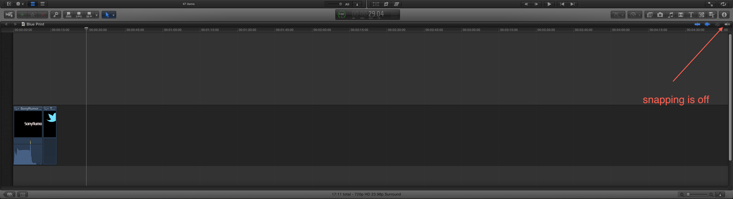

Hey everybody, I used to use Final Cut Studios 3 years ago but recently, for my projects, iMovie has gotten me along. Especially for my content which is usually between 5-15 min of HD content for the web.
One thing I always missed with iMovie is an open timeline so there does not need to be footage between two clips. That empty space, whatever you would like to call it.
However, I can't seem to do this in FCPX. The minute I place another clip in my timeline, it snaps right to the other one. This is even true if I have snapping turned off. Thoughts?
That's probably because of Magnetic Timeline. I'm not sure how to turn that off. It's a pretty nice feature though.

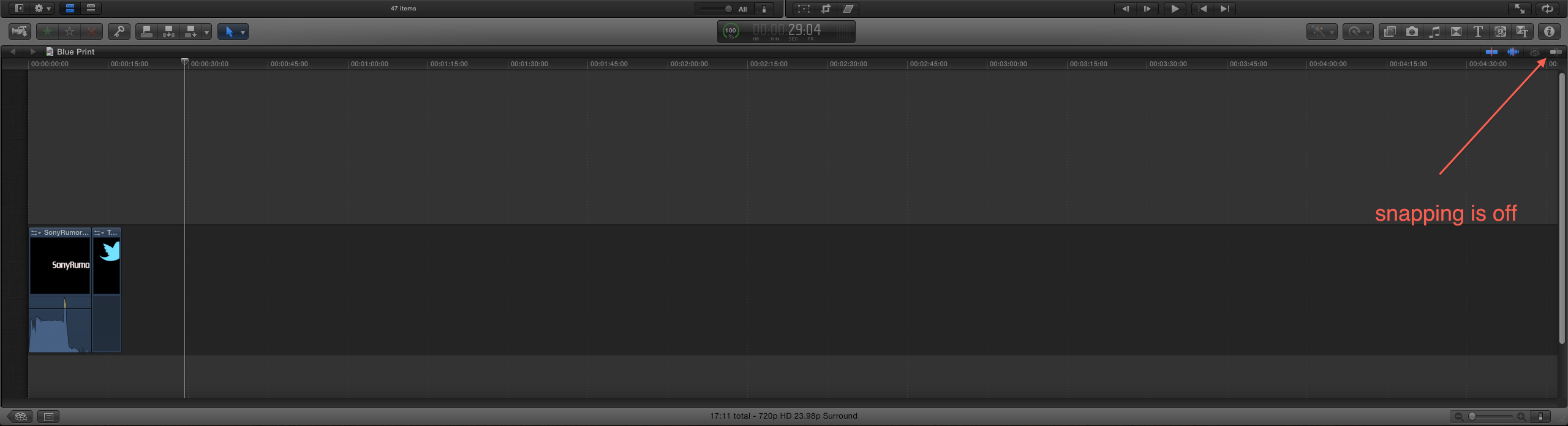

The solution is to have the "Position" tool turned on. Just press "P" on the keyboard and you'll enable the position tool, which will allow you to bypass the magnetic timeline and position items manually.
You can also do that with the magnet on, but have to lay down a slug. There's a free video on rippletraining that shows how to do it.
