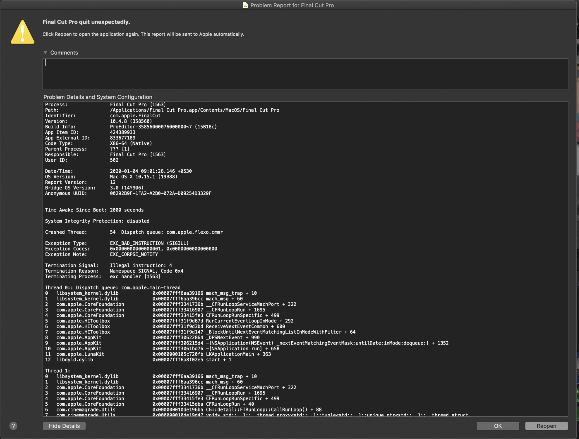

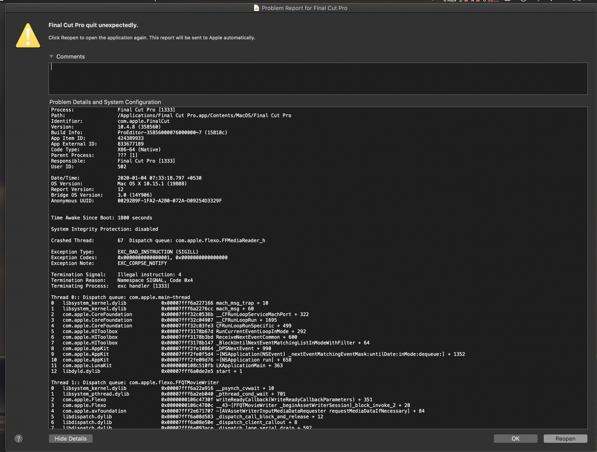

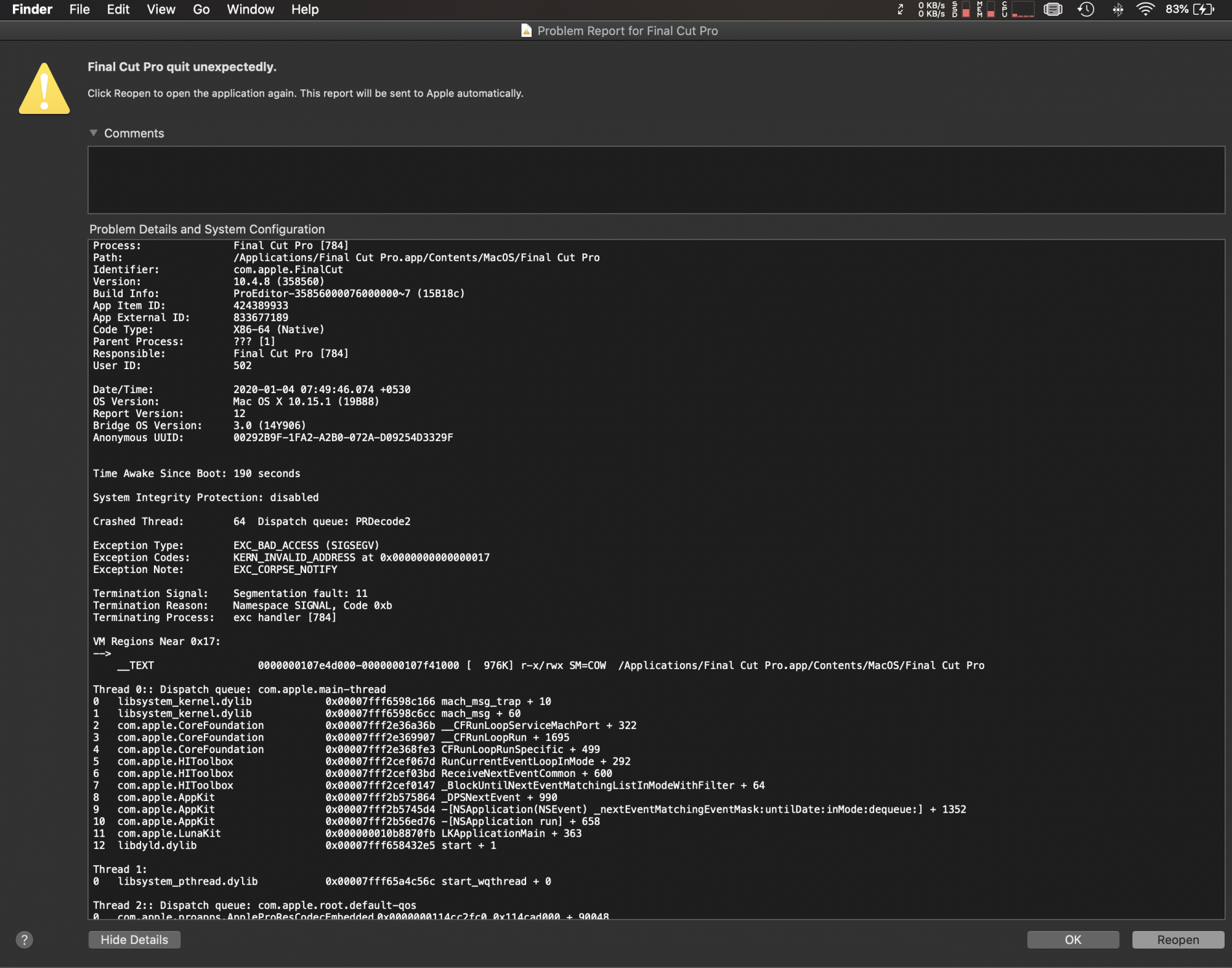

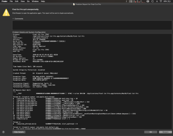

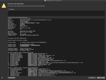

Hi, Im a YouTuber who edits and uploads video everyday, so the MacBook pro 15 never had any issues till date.
But since yesterday, no matter how I try to export, the FCPX is crashing and even MBP is goes into panic reboot situation.
Attached are the screenshots.
Can someone help ?

Its kind of weird.
It crashes many times and then exports once out of 10 trials.
Do you want me to restore the whole mac ?
