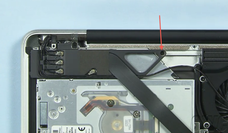

I got to the part where you lift the black plastic connector out, to take out the optical drive, and the screw near the triangle.. it was either a faulty screw Apple put in, or I f'ed it up!
What to do now?! I've tried a collection of screwdrivers and none seem to remove it! I mean, going to an Apple store saying 'Hey, you gave me a faulty screw which I'm not supposed to use' is not really reasonable.
Thanks in advance, stressing out.

You probably need to get the proper size "screw extractor" from your local hardware store. Then replace the one you take out with a standard screw.
So what happened, you mashed the screw head? They may have gone a little overboard with the locktite in the factory and made it hard to unscrew with the correct driver.
These screws are pretty soft, so try using a very very small flathead screwdriver, less that the size of the lateral width of the philips head, and put some weight on the rotating disk at the top of the driver as you start to turn very slowly. You should be able to free it up and get it out of there.
when i changed my stock drive i found out that it they dont use regular screws but rather a torx or some kind, it was like 12am so best that i found was my leatherman utility tool and used a pair of pliers and unscrewed it manually..
My 17" has one such non-cooperative screw that holds the 5400 RPM disk drive - it has its head blunted from my attempts to remove - it doesn't move a bit and I have long history of tearing Macs apart. I gave up on replacing the disk drive and instead got rid of optical drive to add a SSD.
Any one care to give some detailed info on the screw extractors mentioned in above post? Back of my mind I am always worried that whenever it comes time to replace the disk - I may not be able to do so. Oh and I would need a replacement screw - damn you Apple, just QA your machines good to ensure all screws are removable.

You need to use a T6 to remove the optical drive. If you tried with a philips then it's just you not watching what you are doing.
the screws are similar to japanese phillips. If you have mucked about in japanese cameras or elctronics you might know what I mean. They are shallower and narrower than the equivalent sized US screw. So you alway shave to go a size down, which increases the possibility of stripping.

In the OP case I wuold agree that a flat head is your option. I do not know of a screw extractor that small. If you have to drill it out be very meticulous about cleaning up metal shavings. I often mask of the area with masking tape if I have to go so far.

You've obviously not replaced an optical drive on a 2011. They are not T6, the only T6 are on the HD. The screws holding down the optical drive are 00 Phillips and it is not standardized.

According to OWC's video on doing the data-doubler install, the narrator says "in most cases, the optical drive is held in place using phillips screws, but in this particular instance, it's held in place with Torx T6 screws."

Well, here are actual pictures of a 2011 teardown from ifixit. Refer to pictures 6 and 8, you'll see clearly Apple uses phillips screws and not torx to hold the speaker/wireless assembly in place. On picture 8 you can see the edge of the optical drive and the tab that's being secured by again, a phillips. Of the 3 2011 MBP's (13") I've done, not one has had torx screws on the superdrive or wireless assembly. I can't imagine the 15" is much different.

Ditto, I have only seen torx on the hardrives in MBPs.

i followed the OWC video to the T and luckily in my 17" CTO Late April Machine was exactly the same layout as the OWC vid. i remember using the torx T6 for changing the HDD as well as the phillips #00 - i did have to hot/swap btwn the torx and phillips screws when dis-mounting the blutooth module/speaker at the front of the superdrive - this just need the a gently life to clear things covering it and gently angling the phillips 00 screwdriver in to unscrew - similar thing for the screw by the fan.
I had one Wiha 00 Phillips screw driver and a T6. T6 was used on taking the HDD screws off. And then the rest are all 00. This is on the case of 17" 2011 MBP.

I have a 2011 15" and when I replaced my optical drive with the data doubler some of the screws holding in the optical drive were torx not phillips. I used both phillips and torx drivers [and my trusty flashlight to identify each screw before removal] and had no issues at all, took all of 5 minutes to swap it out. This really isn't rocket science people - this is what happens when you don't let natural selection run its course....

Any update? I was attempting to install my Data Doubler and have a stripped screw in what I think is the same location.

I don't think missing a screw in that position would cause you any problems whatsoever. I'd just leave it out. If you take it to Apple for repair for something down the road a bit, if they notice it's missing, they'll probably just put a new one in there. I wouldn't bring it to Apple and ask for a new screw though. I don't think that's necessary at all, and I don't think it's anything you need to worry about.

Has anyone had any luck with screw extractors? I did a quick search but I'm not sure if there is one small enough for the job.

I was hoping someone will try out the iFixit Screw Extractor 🙂
I guess I will give it a shot this weekend - although I am totally not sure how the iFixit extractor works and what are its chances - I don't have a totally stripped screw - just a one with screwed up wedges.
I went ahead and ordered this set from amazon. I'm a little skeptical since the stubborn screw never budged in the first place. I'm assuming there was too much threadlocking adhesive applied in the factory.
