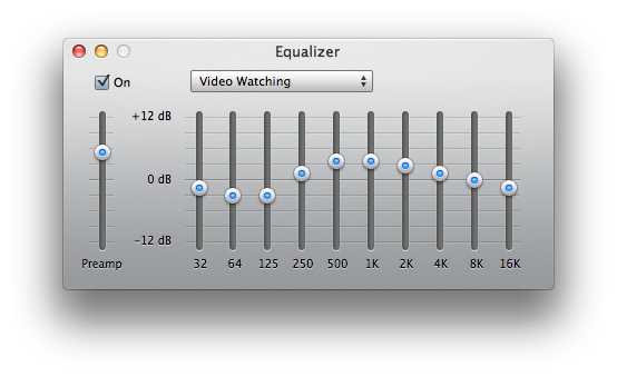

Have you tried selecting the files in iTunes and then "get info"? You can increase the volume output there. When iTunes imports it puts the file volume right in the middle. If you push it up higher here it will be higher when it plays at the same volume setting on the TV or amp. You can select all of your movie files at once and do get info and change them all.
I think I tried that, but I'll look at it again as I'm not 100% sure.
I do this AND I also go into the Equalizer window and add volume there.
I select "Vocal Booster" from the drop down menu.
Adjust the preamp slider to raise the volume.
Save the preset as "video watching" or something like that.
