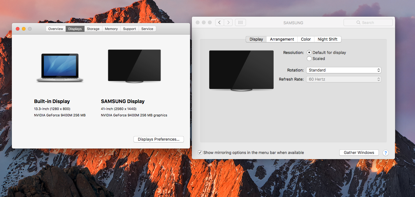

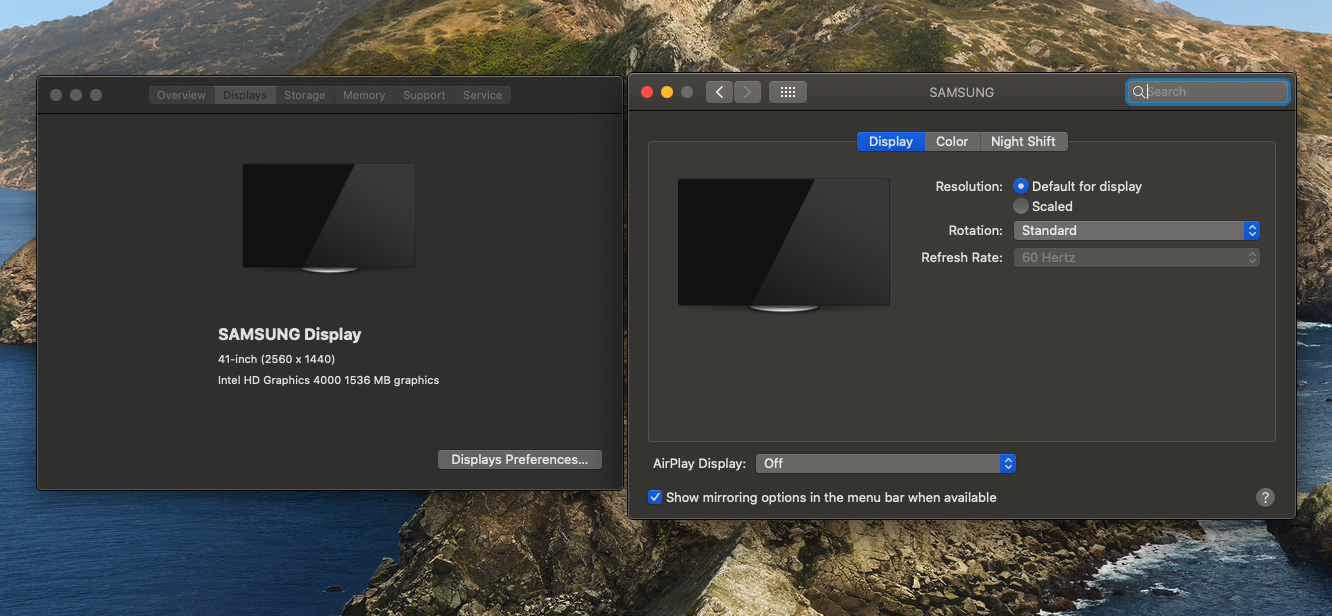

Just a quick update. I've found a cable "ALOGIC Fusion 4K Mini DisplayPort to HDMI Active Cable (2m)" that works. First I tried a more expensive one "ALOGIC Ultra Mini DisplayPort 1.4 to HDMI 2.0 Active Cable (2m)" that did not work and I had to return it. I'm glad I did not give up on this project as 2560X1440 is much better than 1920X1080. For some reason my 32" monitor registers as 41" but I guess it does not matter.

It probably has something to do with the 4K active cable I am using right now. My old passive adapter was registering a proper 31".
You could examine the monitor's EDID using SwitchResX [using the active cable first, then the passive one] and compare the image dimensions - or provide the EDIDs here so I can have a look.

I've had a look at your 50-inch Panasonic TV's EDID. The image size is given as 698 × 392 millimetres, resulting in a 31.5-inch diagonal according to the Pythagorean theorem: just what macOS reports. So, Panasonic is to blame for stuffing bogus data into the EDID, not macOS 😉
For your Polaroid TV, the image size in the EDID is given as 930 × 530 millimetres, resulting in a 42.1-inch diagonal. Is this correct?
No it's not. The TV is 22 inches not 42.1. Another case of the manufacturer providing misrepresentative data. 🙂
