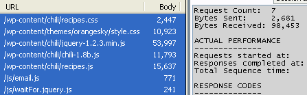

If you have a couple of css files, the best way of serving them is to use Minify, as i mentioned before, because you will not have served files in this form:
but you can have served files (css for example) in one line:
<link type="text/css" rel="stylesheet" href="/min/b=wp-content&f=chili/recipes.css,themes/orangesky/style.css,plugins/jquery-comment-preview/jquery-comment-preview.css" media="screen" />
where those files will be also compressed. So the accent is on reducing the numbers of HTTP requests and also compressing the same files (.js and .css)
