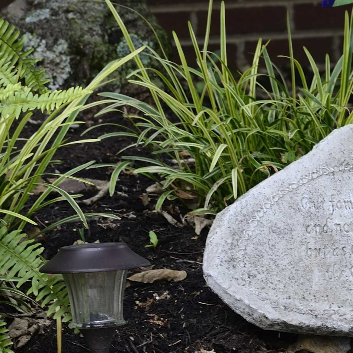

In any case, here's what I have-first images resized for the web(which show little difference).
D3s

Now, a 100% crop. This started as an 800x800 pixel area on the D3s, and I did my best to get a 1:1 crop showing the same area on each subsequent camera(although obviously the images are much larger).
D3s

I hope that this quick test might be somewhat useful to folks wonder if-for example-it's worth moving to a higher resolution camera.
I'm confused, your 800x800 "100%" zooms cannot be 100% in the higher resolution cameras otherwise the image framing would have changed...as is you are showing little difference in normalising the different cameras to the same image size, frame and resolution, sure the higher-res camera's could go further (and the Kodak is already struggling), but that is known already surely???
Sorry, I'm not sure what you're asking/citing as a problem.
The D3s is the only crop that is 800x800, and on all the others I took a crop that covered the same AREA of the image and let the actual resolution fall where it may. If you enlarge the D800 image, you'll see that it's nearly 1600x1600 pixels, but shows the same area as the 800x800 crop from the D3s.
All the crops APPEAR as the same size in the normal view as that's how MR displays them, but if you click on them they will enlarge to their actual size.
If there is a better way to show this information, I'd love to hear how to do it-as I said I normalized the image area, not the number of pixels in the crops.
Ah that explains it, on a scroll down while at work I hadn't clicked through.
So you are attempting to show the differences between MP sensor size on full frame. In other words, what is the real world difference between a 12 MP, 24 MP, and 36 MP sensor.
Since the focus is different between the shots, it's hard to really compare.
Also there have been improvements in other aspects of sensor design/performance over the years that complicate a direct comparison.
One advantage of higher resolution sensors is that they give you larger files to work with. So it is easier to print larger without loss of image IQ or you can crop more aggressively without loss of image IQ.
To show this, you should crop to 100% on the highest resolution body (in your case the D800). Then crop the images from the other cameras to show the same field of view (which will result in crops at >100%). IQ differences with the smaller MP bodies would be expected to be more obvious in this case. They don't have the MP on the sensor side to resolve detail at this level of magnification.
The "real world" question is whether you need this level of detail for what you are shooting and how you plan to use your images. If you routinely need to heavily crop your images then the answer is yes. If you need to print large the answer is yes. One drawback of high MP sensors is that focus errors become more obvious.
Higher MP sensors aren't all about sharpness however. There are also issues of dynamic range, noise, leeway in how the files tolerate manipulation in post. Not strictly MP issues but also sensor generation issues. And also issues about how RAW files are managed by the camera. For example, the Nikon D850 produces largely gapless RAW files on histograms compared to the RAW files from the Sony A7R3 which have large gaps in their RAW histograms (data from DIGLLOYD.com).
I would suggest you shoot the comparison again with an emphasis on keeping the focus constant (which may be challenging as there may be AF differences between the bodies even with the same lens that aren't easy to correct--really need to focus with Live View to do this and some of your bodies don't have this ability).
I would also keep the ISO at base for each body rather than keeping it constant between bodies. Changes in ISO affect sharpness and base ISO for a given body will result in the sharpest images the body is capable of producing. If you are shooting on a tripod, then shutter speed is irrelevant and you can keep overall exposure constant between bodies.
Full scene images (scaled to web size) are useless for any comparison. Would only share 100% crops from the highest resolution body and then share similar field of view images from the other bodies (which will be cropped at >100%). That will show off (at least in one sense) what you gain with higher MP bodies.
