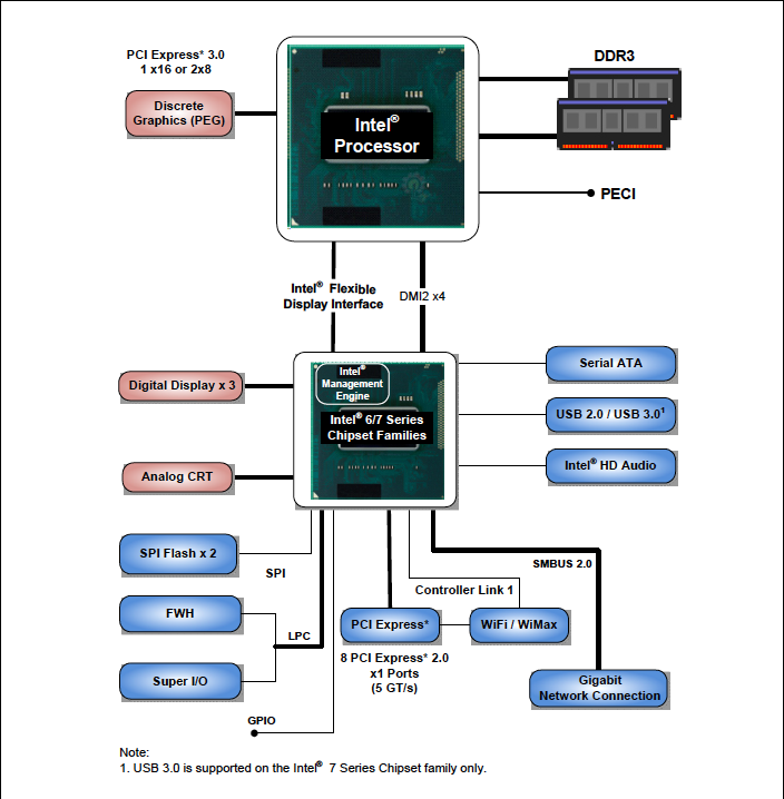

Try looking at this from an Intel point of view. The Light/Eagle/Cactus Ridge Thunderbolt controllers were designed specifically for LGA 1155 platforms. Here's a diagram of such a platform:
You may note that 90% of the CPU's I/O is reserved for graphics or display applications, and the PCH has 17.28 Gbit/s of FDI bandwidth but only 16 Gbit/s for the DMI (although the DMI is full-duplex). Furthermore, HD Graphics 4000 occupies 1/3 of the die area of an Ivy Bridge CPU. Display is clearly very important to Intel's customers.
Do you find that the PCH on 2nd and 3rd gen Intel Core processor systems is crippled because it hosts a melange of I/O and display functions?
How often do you think that users of these systems experience noticeable performance degradation due to DMI bottlenecking, despite having a front end that's more than 4.5 times as wide?
Aside from those provided by the Port Ridge controller, all Thunderbolt ports can operate in two signaling modes: Thunderbolt (when it's connected to a Thunderbolt device), or DisplayPort compatibility mode (when it's connected to a conventional DisplayPort device). In Thunderbolt signaling mode, each link is comprised of two 10 Gbit/s, full-duplex channels. What types of packets (PCIe or DP) you choose to transport over those channels is entirely up to you. Each channel is wider than PCIe 1.0 x4 by 25%. I've pointed this out repeatedly, but it still doesn't seem to sink in; the only scenario in which DP packets limit PCIe bandwidth is when you're trying to write more than 8.4 Gbit/s of data to a Thunderbolt device daisy chained off of a pair of Apple Thunderbolt Displays. Reads simply cannot be impacted by DP, and the aforementioned situation can be avoided completely on any host system with more than one Thunderbolt port.
Thunderbolt is clearly designed with the goal of relocating southbridge functions outside the box. The back end of a Thunderbolt controller is nearly identical to that of the PCH. 2x DisplayPort 1.1a is directly equivalent to FDI, and PCIe 2.0 x4 is the same as DMI 2.0 x4.
I'll also take a moment to comment on daisy chain vs. tiered star topologies. You don't prefer daisy chains. That's legit and I get it. Thunderbolt can also be configured in a tiered star via switches. The silicon for those switches is not being produced, however, because there is no market for them. The retail cost would realistically be $100 or more per port, so a 6-port switch and one cable would cost $650, i.e absolutely prohibitive. Daisy chaining is the time honored solution for situations such as this. Parallel SCSI and IEEE 1394 are obvious examples, but perhaps you also recall the days when Ethernet hubs and switches were expensive enough that most small networks used 10BASE2, which was more or less the same theory. Thunderbolt is also distinct from those examples in that the nodes on the daisy chain are not connected via a shared bus. Essentially a 2-port Thunderbolt device contains what amounts to a 2-port (4-channel) switch. So the topology of a Thunderbolt chain is analogous to a chain of 4-port switches with 2 links between each switch.

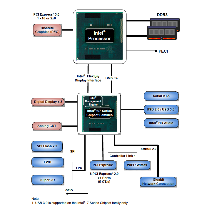

What if you want to put 4 T-Bolt ports on a performance laptop (hypothetical question on this forum, since Apple doesn't make any performance laptops).
The chipset doesn't support 4 graphics devices, so what do you do about the graphics channel on the 3rd/4th T-Bolt connector?
That's the problem. If T-Bolt were PCIe extender only - no problem.

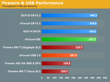

It's been that way forever. A classic example is how FireWire 400 (400mbps advertised) was about twice as fast transferring data as USB 2.0 (480mbps advertised).
And this is a classic example of fabricating "statistics" without citing any actual data.
Please support your "twice as fast" claim before we believe anything else in your post.
In my experience (using external drives with both USB 2.0 and 1394(a)), I'd see a bit more than 30 MB/sec using the USB interface, and a bit less than 35 MB/sec using 1394.
Anandtech even showed USB 2.0 beating 1394.
