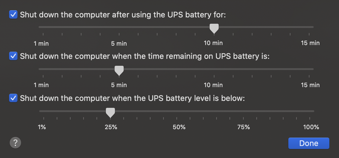

Every single Mac that I've had UPS connected via USB - it shows up under energy saver preferences, under a UPS tab. Basically treated the same way a MBP has battery and power adapter.
There are shutdown options like this by default without any software installs required for the UPS's I've used: Screen Shot 2020-11-02 at 11.08.53 AM.png

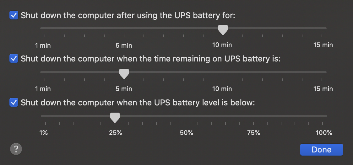

There are shutdown options like this by default without any software installs required for the UPS's I've used:View attachment 977617
Thanks, none of the instructions mention the detail of what causes the UPS tab to appear, it’s not like it’s there with a “no UPS connected” message otherwise.
I’ve seen those power off options, I was more thinking if there’s a way to automate things so that if the machine is asleep, it can wake up and save state, then shut down, if the UPS crosses certain thresholds.

Do you happen to know what occurs when a UPS triggered shudown encounters an app with unsaved documents? On a normal shutdown (iirc), that'll halt the process (or does it go to a countdown?) with an alert in that app. Does the system treat a UPS shutdown differently?
The few times I've had a UPS triggered shutdown, believe the apps saved on quit. This was before APFS system drive. The saved state for sleep mode might help out here slightly. Power management overrides, goes to shutdown - like what would happen when an MBP battery dies and you don't plug it in.
