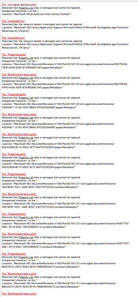

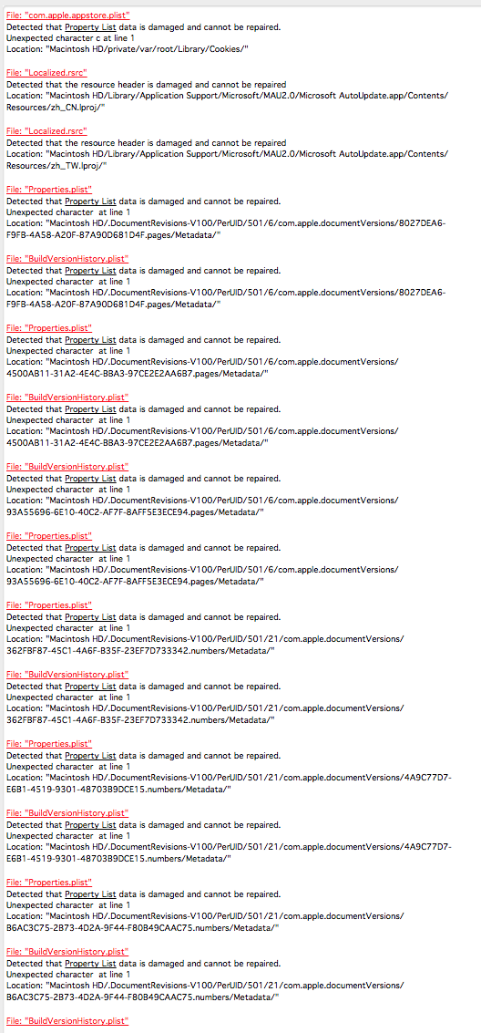

The files shown below are corrupted according to a DiskWarrior file check. It was my understanding with earlier OS versions, that the solution was to discard a bad pList, and then the parent Application (or the system itself) would refresh it in the same Library folder. I have done this with Applications before.
I fixed Permissions in Disk Utility before doing any of this.
And now, running 10.9.3 as my system, I navigate to the GO drop down menu at the top of the screen. While depressing the OPTION key. The LIBRARY appears in the menu.
Why can't I find most of these items in the Preferences submenu of Library?
Where are they hiding?
Is the solution to throw them away?
Does any of this matter, or is Disk Warrior sending a false alarm?

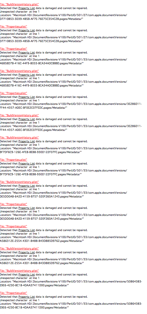

What you are seeing there is stored versions of Pages documents you created. They are in a hidden folder at the path below. If you open Finder then click the Go menu then Go to folder and enter the path below you will see the files.
Unless you are having some problem though, I would just ignore this. I suspect there is nothing wrong at all and DW is just flagging these files as bad plists when they are not.
Code:
/.DocumentRevisions-V100/PerUID/501/33/com.apple.documentVersions/
