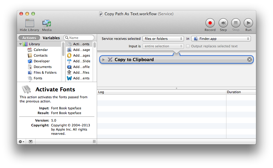

To answer your question, yes, it's a Service. Really simple:
Service receives select [files or folder] in [Finder.app]
Copy to Clipboard
I added a screenshot.

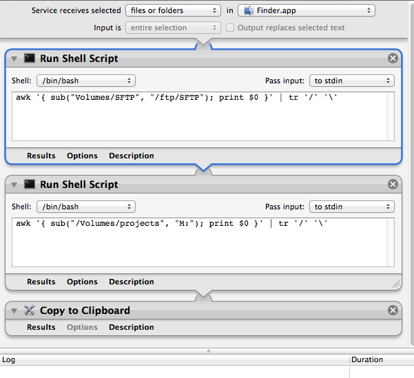

I used the previous script you gave me
awk '{ sub("Volumes/SFTP", "/ftp/SFTP"); print $0 }' | tr '/' '\'
I changes what is in the sets of double quotes to make another script
awk '{ sub("/Volumes/projects", "M:"); print $0 }' | tr '/' '\'
They each work, but only independently. In my new screenshot, I show them both enabled, but they only work if one is disabled.
The first one you know, that dealt with an ftp server. Note: I added a little additional text to the input and output strings, so it would be able to differentiate between Volumes/SFTP and /Volumes/projects. The second needs to do a similar conversion, to a project server.
So I'm looking to convert this type of server location (with all script disabled):
/Volumes/projects/z_General
to this Windows Formatted one:
M:\z_General
I cobbled together a new script from the one you gave me. And I'm aiming to make the script(s) smart enough to be able to determine which volume it's coming from.
Otherwise it is easy for me at this point to save the existing service as "Save Path as Text (FTP)" and the new one as "Save Path as Text (Projects)"
I need to re-read your recent post and check the links, but I wanted to give you the clarification you asked for. This is no big rush and at this point I'm idly curious. I am sure you have other projects to tend to as well.
Thanks again.

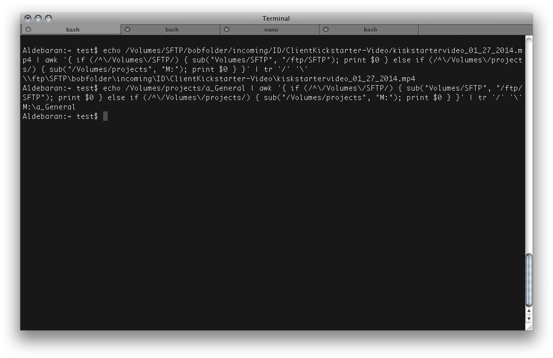

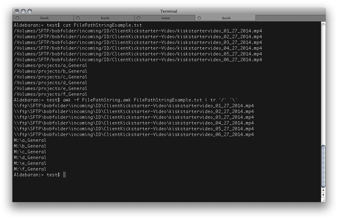

Try this :
Code:
awk '{ if (/^\/Volumes\/SFTP/) { sub("Volumes/SFTP", "/ftp/SFTP"); print $0 } else if (/^\/Volumes\/projects/) { sub("/Volumes/projects", "M:"); print $0 } }' | tr '/' '\'
Put this as the entire script of a single "Run Shell Script" action:
Code:
awk '{
  sub("^/Volumes/SFTP/", "//ftp/SFTP/")
  sub("^/Volumes/projects/", "M:/")
  gsub("/", "\\")
  print $0
Follow it with the "Copy to Clipboard" action.
There only needs to be one "Run Shell Script" action. This single script finds and replaces both of the patterns you asked for. It also does the '/' to '\' conversion, so the 'tr' command is no longer needed.
This script relies on some specialized awk features.
First, if the sub() function, which performs substitutions, doesn't find the requested pattern, then it has no effect. Therefore, overt conditionals (such as kryten2's use of 'if') aren't strictly necessary.
Second, the '^' at the start of the pattern means the rest of the pattern must be at the start of the string in order to match. For example, it will match "/Volumes/SFTP/example", but not "/Users/aname/test/Volumes/SFTP/sample".
So the 1st sub() only matches and replaces within lines that start with the pattern "/Volumes/SFTP/", and the 2nd sub() only matches and replaces within lines that start with its pattern.
The gsub() then replaces every instance of '/' with '\', in any line that has any slashes. As with sub(), it has no effect on lines without its pattern (i.e. lines without slashes).
Finally, the print $0 prints the resulting line, which may have been acted on by 0, 1, or 2 replacement operations.
I tried to make this as simple as possible but still readable, so if you have to change it or extend it in the future it won't take deep knowledge of awk or bash. However, if you run into problems changing it, feel free to ask again.
