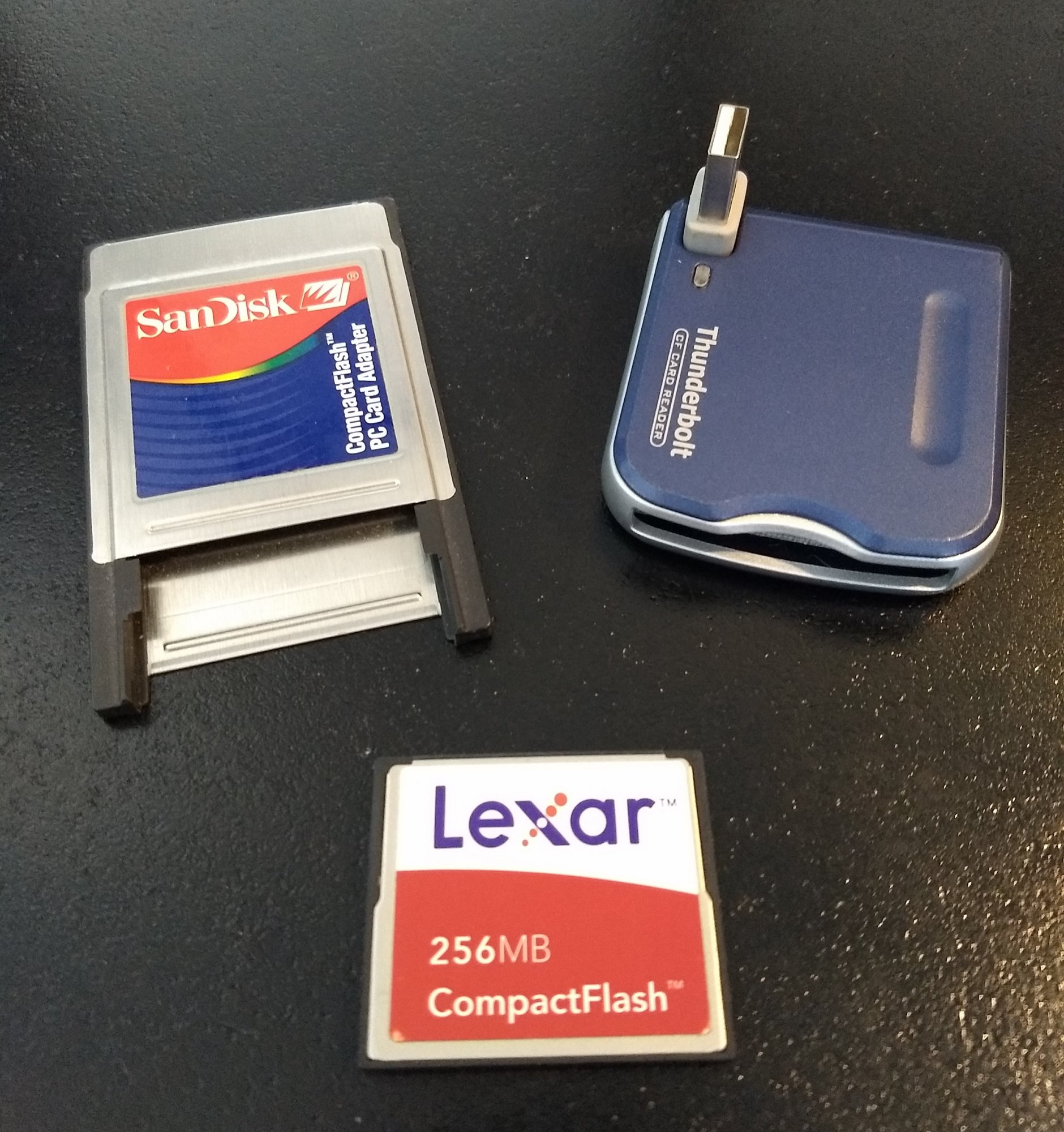

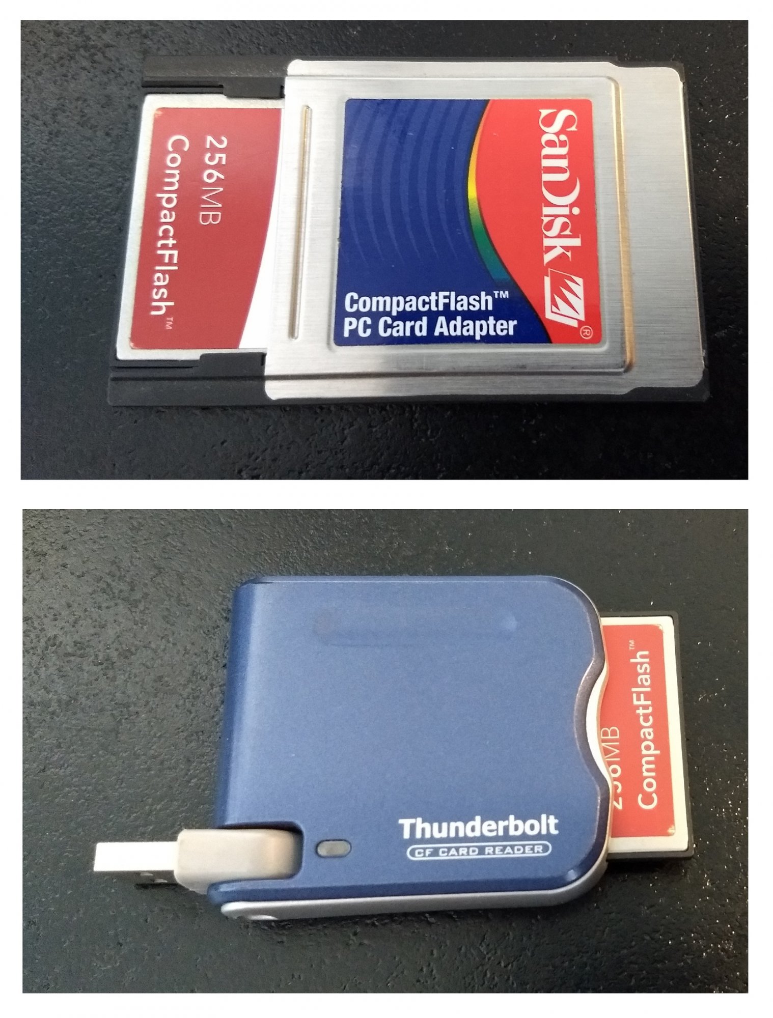

Not being so network-savvy, here's what I would (and do) use: Your PB1400 has two PCMCIA/Cardbus slots on the side. These are much more useful than the floppy drive ever was. With a Compact Flash (CF) PC Card adapter, you can read and write to CF cards just like you would a floppy, only much larger amounts of data and much faster. You can even put an OS on it and boot your PowerBook just like it was an SSD.
To then interface the files you've written to another computer (that lacks a PCMCIA slot), all you need is a USB card reader. Works like any USB flash drive, except the media is removable. Just put whatever you want to move onto the CF card with your PB1400, then eject the card adapter, remove the CF media, and stick it into the USB CF card reader. Stick that into whatever computer you're trying to transfer files to, and as long as the files are in a recognizable format, you're golden.
There are many varieties of this hardware you can use. These are mine:
Varieties of the above can be had very cheaply on eBay and elsewhere. You could probably pick up something like all of these for less than $10, all included, if you shop a little (btw, ignore the "Thunderbolt" nomenclature on the USB card reader, that's just a brand name... has nothing to do with the much newer Thunderbolt data interface).
