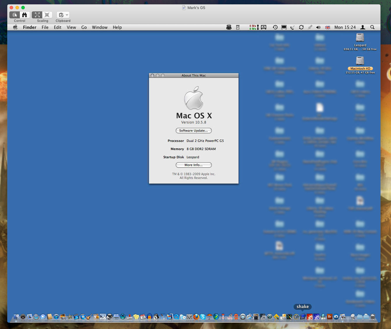

After heading down the correct route, Screen Sharing is sorted....😛
Doing the proper way only took about 30 mins, if that.
Thanks @eyoungren, @theMarble, @doctor_dog for all your help, much appreciated.
Now it's set up correctly, I realise how easy it should have been....🤣
