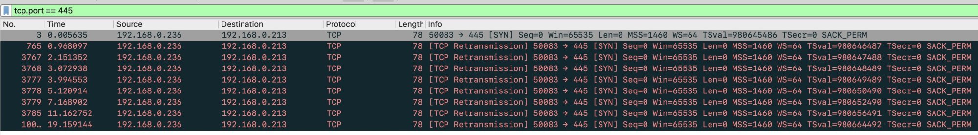

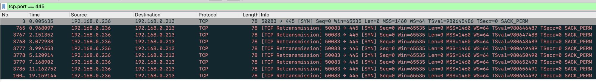

Whenever I try to connect to SMB from another Windows/MacOS machine or Android phone I get these TCP Retransmissions:

I'm happy this thread exists - I noticed the problem after rebooting for an update and couldn't figure out why I could no longer connect. I was using a Linux box as a fileserver - but decided to move the drives to my Mac, so this didn't bite me until now.
I eventually realized that when shutting off the Firewall connections from clients could be made. I ended up finding an article on 6 colors about adding smbd to the firewall and making sure that it was not blocked using
Code:
/usr/libexec/ApplicationFirewall/socketfilterfw --listapps
But nothing helped. The tip on shutting off file sharing before rebooting is the only thing that really works(?) so far.
