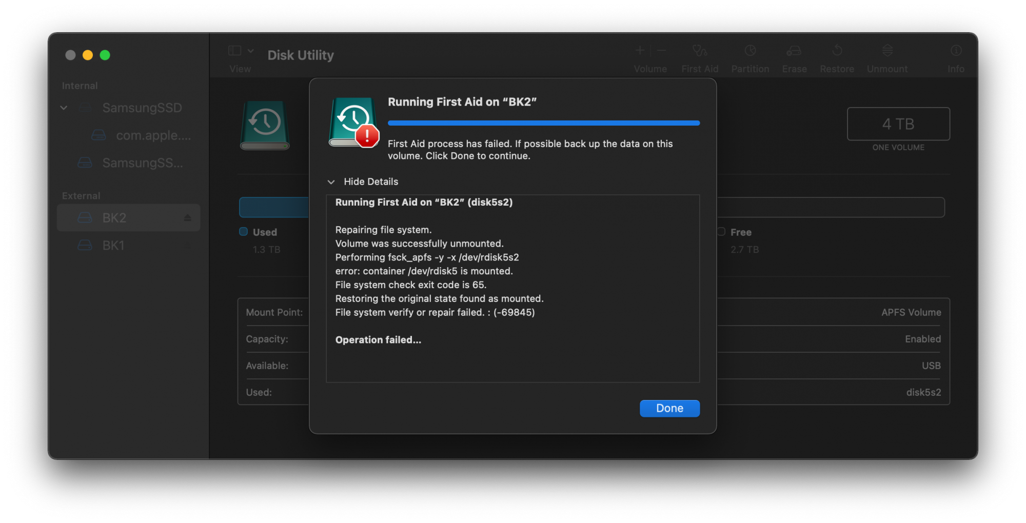

After I updated the MacOS to 11.5.2, the old external disk random ejection problem has returned. All my USB devices (HDs, webcam, microphone, speakers, etc.) would randomly disconnect from the MacPro. So I tried to debug the system. According to some articles, one should verify if the HDs are good first.
So I use Disk Utility to perform first aid on my two backup HDs. Then I got the following error:
Then I rebooted my MP and checked again on two HDs. No problems with them. But then I ran the Disk Utility after a few hours, the problem returned. Then I reboot the MP and immediately check again, no problem.
These HDs are LaCie drives I bought from Apple Store. So I contacted LaCie and they told me these disks don't have energy management software.
I contacted Apple Support and a Sr. Advisor worked with me to reinstall the latest MacOS. But it does not help the problem.

I ran the Disk Utility on the main system SSD and found errors too! It has errors on the snapshots:
warning: Cross check: Mismatch between extentref entry reference count (2) and calculated fsroot entry reference count (1) for extent (112624268 +4)
I am now thinking to erase all these drives....

I have the following drive and had this issue no mater what I tried for months. My issue was solved by changing my USB-C cable that came with the drive. Might not be solution for everyone, but thought worth it mentioning it here in case it helps someone else too.

With the inspiration of another poster who said replacing the cable helped, I tried just unplugging the USB connection and reconnecting it. I unmounted first, and I used a different port. The error went away!
I got the Check Exit code 65 on an external HDD (USB) running as a Time Machine backup (APFS and encrypted). I am running 12.3.1 on an M1 MBP 16.
I read somewhere that Disk Utility was failing on encrypted volumes attached by USB, so I tried booting into Recovery, then running Disk Utility from there. I did, and it asked me to enter the password for that external encrypted Time Machine disk. It then performed the disk check fine, without errors (can take a while, though, checking each snapshot).
I doubt this will fix everyone's issues with the error 65, but I hope it helps some.

Just to add on to what moisesalejandro said: Same issue, same brand (5TB not 2TB, but WD), same solution. My theory is the wire they ship with the drive doesn't work with OSX for some reason. The Disk Utility fails to detect that the drive is encrypted, and failed with check 65. Switch cables and it will work.

Also I recently found that manually unmounting my drive before running first aid on it seemed to solve the error code; it's possible that the error arises from the software trying to unmount the drive?
