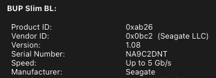

What does System Info say the negoitated link speed is for the target USB drive and interface? 35MB read is barely faster than USB2. That said, even @ 35MB/sec read, 268GB should only take around 2hrs 20mins to transfer.

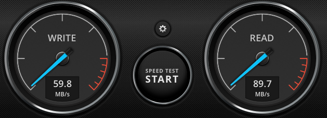

Just repeated the process with an inexpensive Seagate USB3 drive locally connected to a USB3 Mac Mini port (5Gbps so USB3 speeds). Unfortunately I dont have another USB3 drive at home to test USB3 - USB3 throughput.
This is about as fast as this 2TB drive goes as its NOT a high performance model :-(

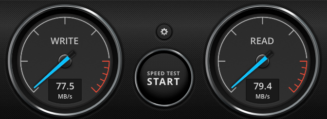

Same drive connected to USB3 hub via monitor - similar/same results (its mostly full so some variability is expected):
