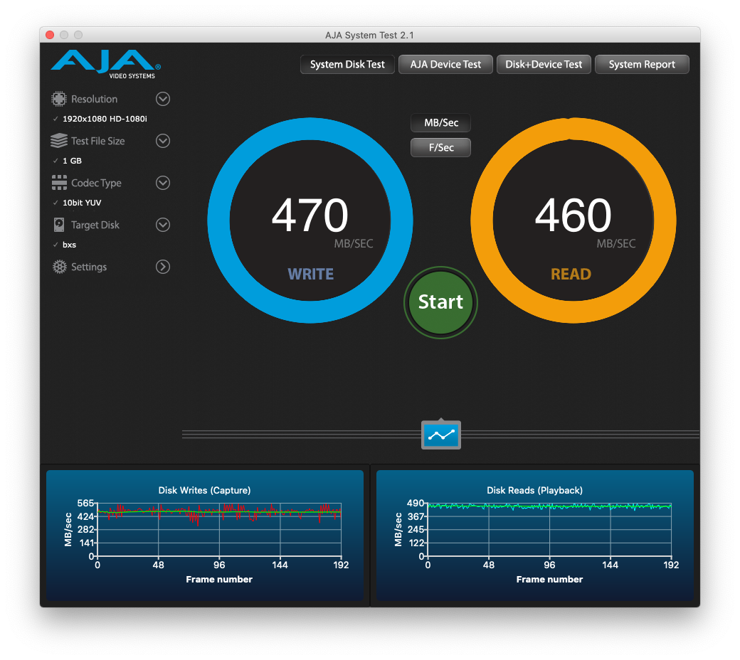

  1. The MP7,1 has 2x 10G ports and I have a Promise SANLink 3 10G/TB3 adapter. So I ran a 10G Cat7 cable between the two Macs using the SANLink 3 adapter to connect to the MBP13,3, and ran AJA to obtain average data transfer read/writes. See attachment.

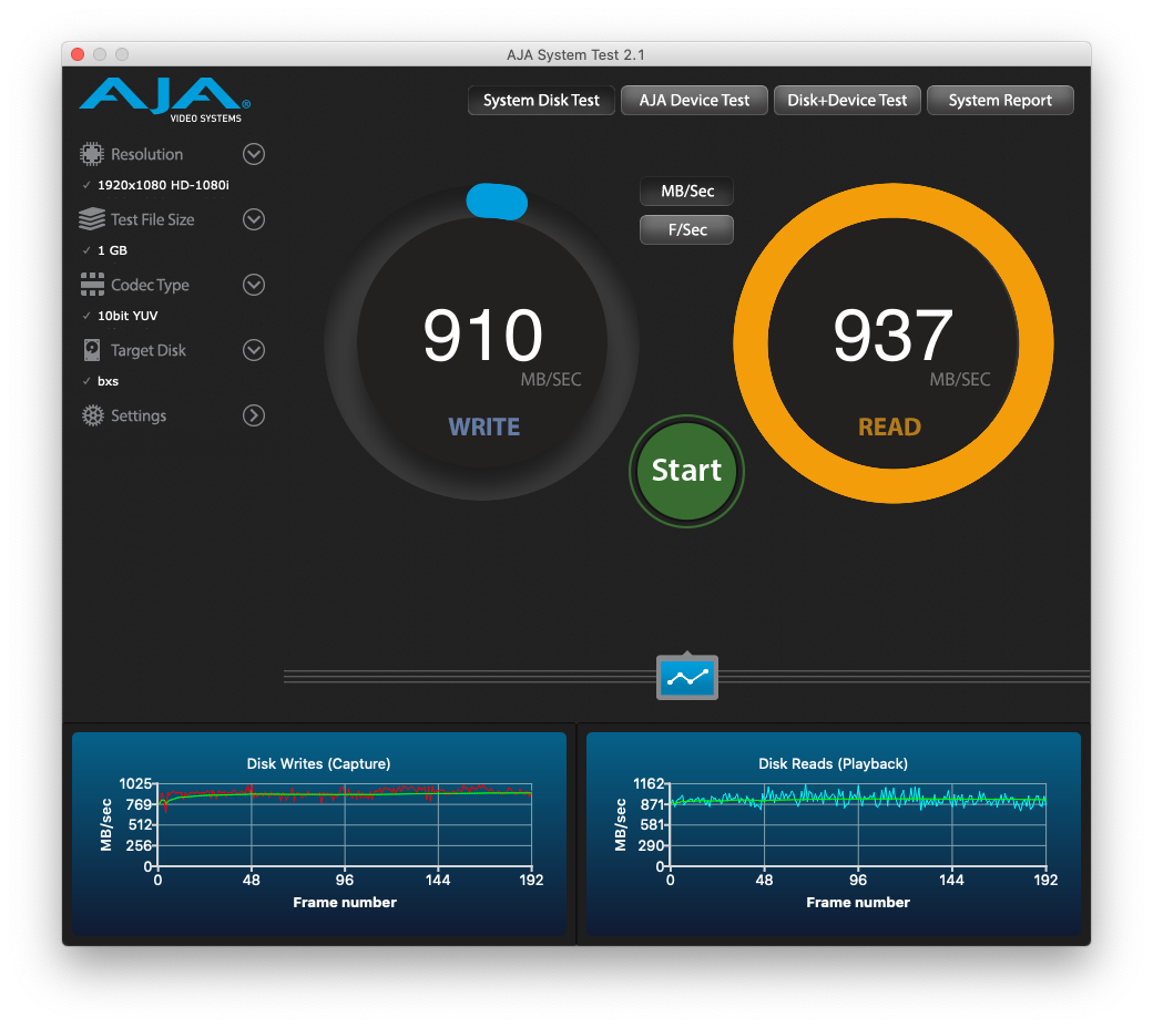

  2. I abandoned the Cat7 connection and used a TB3 certified cable to connect the MP7,1 and the MBP13,3 directly. I then ran the same AJA as I did in 1). See attachment.

  • Using 10G: Writes averaged 470 MB/s and Reads averaged 460 MB/s.
  • Using Thunderbolt Bridge: Writes averaged 910 MB/s and Reads averaged 937 MB/s.
  • Thus, Thunderbolt Bridge indicated it was 2x better than 10G.

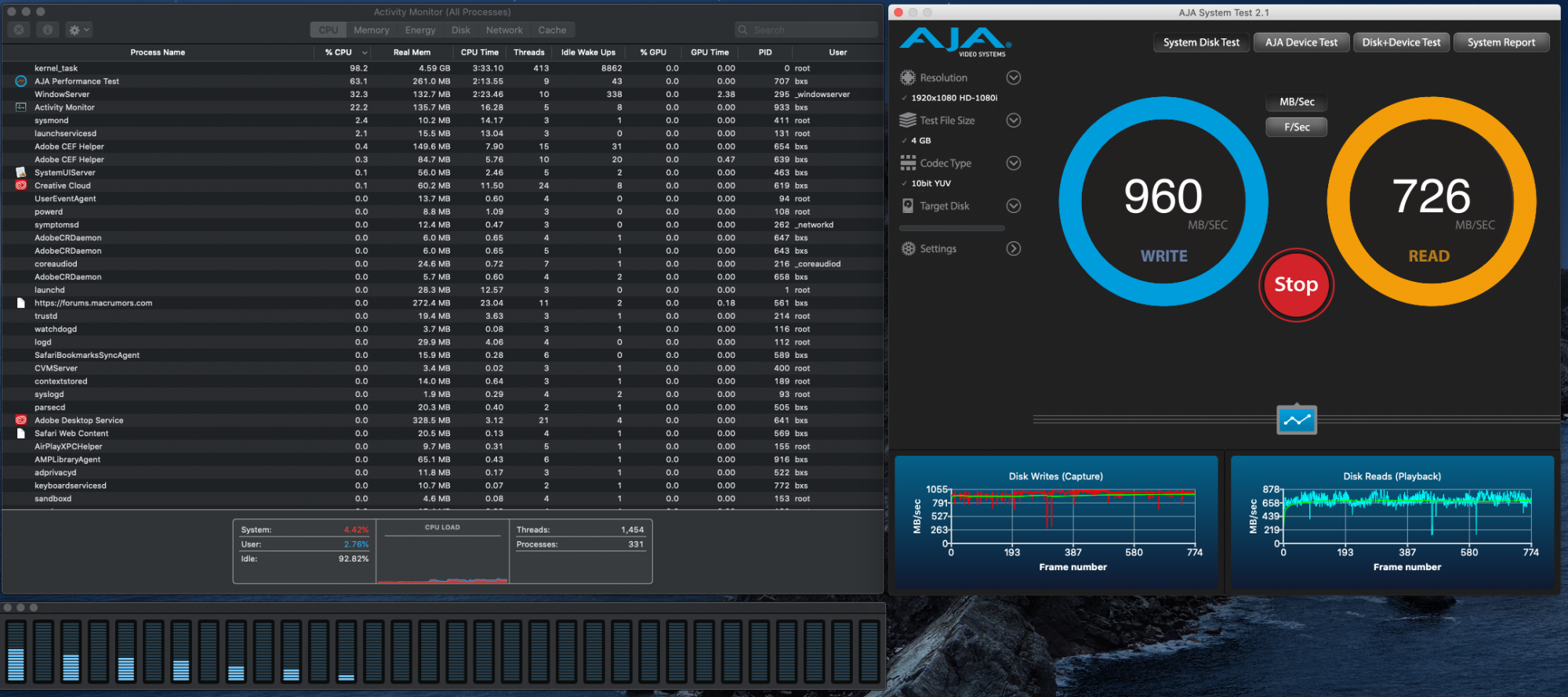

Hmmmm, so I was wanting to understand why my 10G connection between my MP7,1 and my MBP13,3 was running so poorly. I decided to up the buffer size from the default 1500 MTU to Jumbo frames at 9000 MTU at both ends and gosh, that made a big difference for me. See attachment. 👍 👍 👍

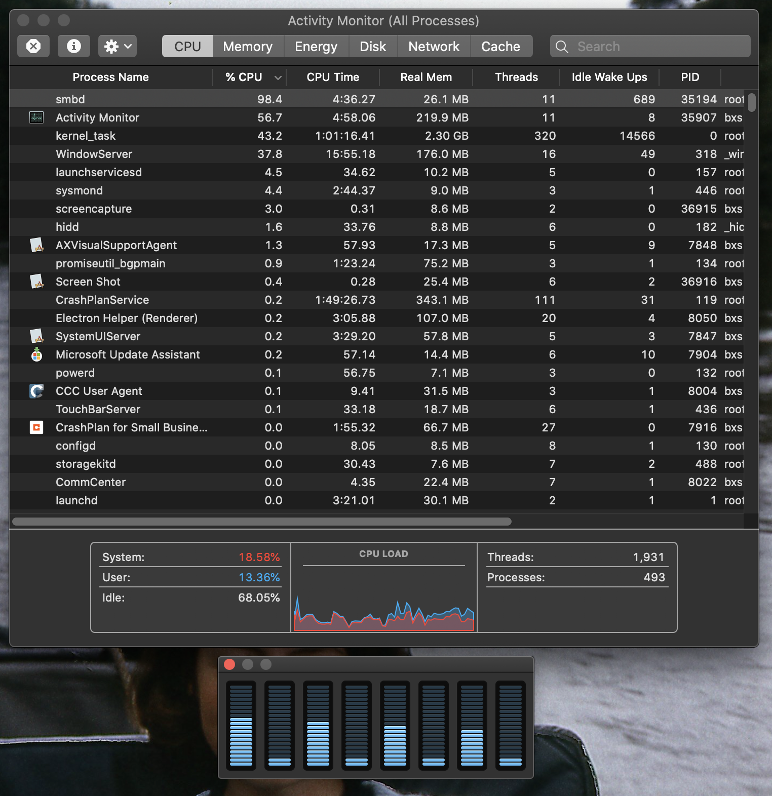

Yes, CPU use during data transfers over 10G between my MP7,1 and the MBP13,3 is not trivial. See attachments.
The file transfer agent smbd on the MBP13,3 and kernel_task on the MP7,1 both are taking CPU cycles during data between the MP7,1 and MBP13,3. Of course the MP7,1 doesn't care as it has tons of horse power, but the MBP13,3 isn't so lucky.
See attachments. This was with AJA on the MP7,1 moving data to/from the MBP13,3.
