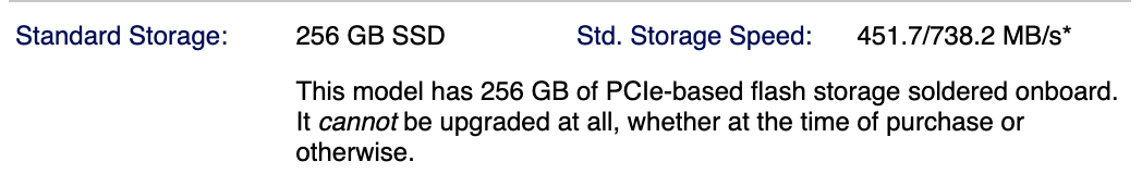

Is it certain that the SSD cannot be removed?
I believe this is your Mac model:
As far as I know, it's impossible to access the SSD outside the logic board it's soldered onto. And if it's not impossible, I'd guess it would be extremely, EXTREMELY hard to do. It's not something a casual snoop would be able to do I'm sure.
