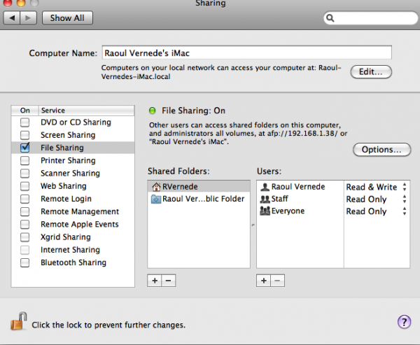

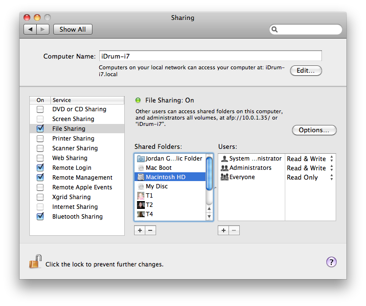

can you please post a screen shot from System Preferences -> Sharing -> File Sharing? i feel that the answer will lie there.
i am sharing Macintosh HD to authenticated users with W&R, the rest can only read.

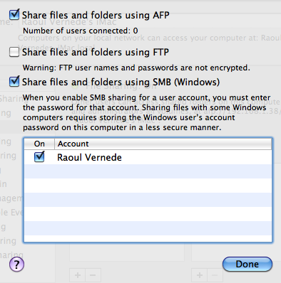

It works fine here. The settings for sharing that the previous poster mentioned doesn't matter for Windows sharing. Click on "Options", check the box for SMB sharing, and turn on sharing for the particular user account. Then from Windows, you need to connect via that account. In the explorer address pane enter \\systemname where "systemname" is the name of the Mac. You will be prompted for name and password which must match the account to which you want access.

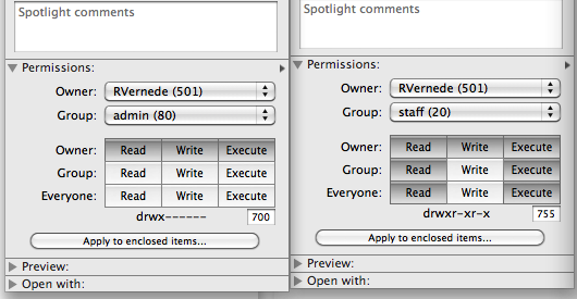

Think I have a clue. It has something to do with rights on the folders. See screen shot below.
The right is accessible but the left not. So I still log in to the mac as everyone?
You are setting general permissions in System Preferences, but the folder permissions will restrict access. If it doesn't ask for your login and password it won't give anything but "Everyone" access rights.
