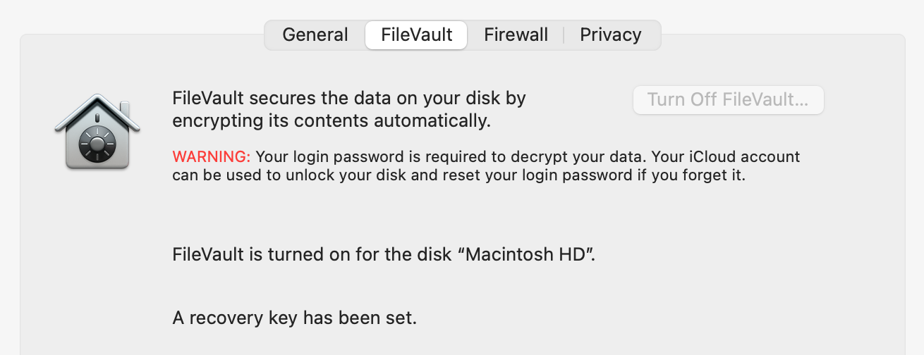

This is what it looks like on my old MacBook Pro (2015). Note that it references iCloud being setup.

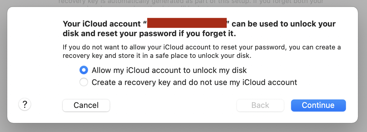

On the new MacBook Pro (M1) setup from scratch, I chose this option:

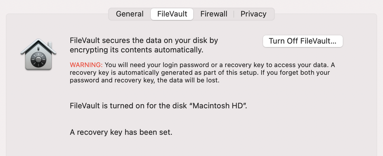

But after it's setup and turned on, instead of seeing what I think I should see (and what I saw on my old MacBook Pro), I instead see this:
At no time did it show me a recovery key. I'm a bit nervous something really weird is going on with the pre-installed OS on the new machine.

I see the same thing on my M1 MacBook Pro, but the system does report that FileVault is enabled.

I got the issue escalated to Apple Engineers via a senior support rep. The response I got was that this is the current behaviour for M1-based Macs, and that the recovery key should be properly stored in iCloud despite the messaging not saying so. Not sure if this is a bug in the UI for Big Sur and M1 Macs, or just a difference in intended behaviour. I noticed that the 11.1 update has not changed this at all.
