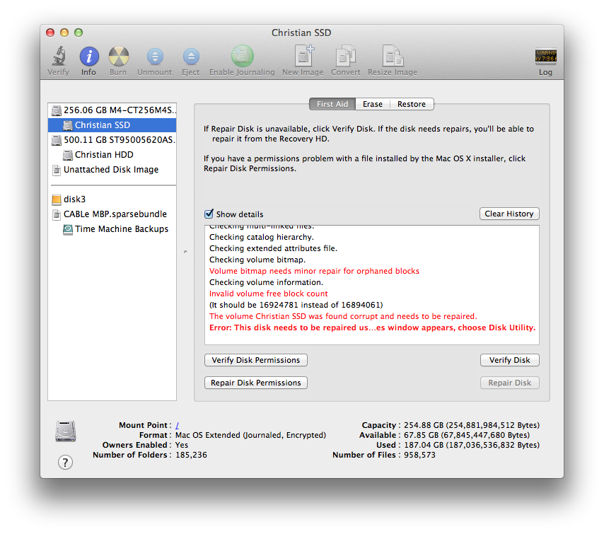

Is there any way to "repair" the disk while I have FV on? I tried these and the partition is still greyed out. When I verify the disk, I get these messages.
Is this Disk Utility the one from the recovery partition? If yes, then you have to select "256.06 GB M4..." disk. You have currently selected a partition on the disk. For disk repair, you have to select disk itself.
If no, then after booting from the recovery partition, you have to first mount the disk you want to repair. Disk utility will ask you for your FileVault password to unlock the disk. After that it should be able to verify and repair the disk.
