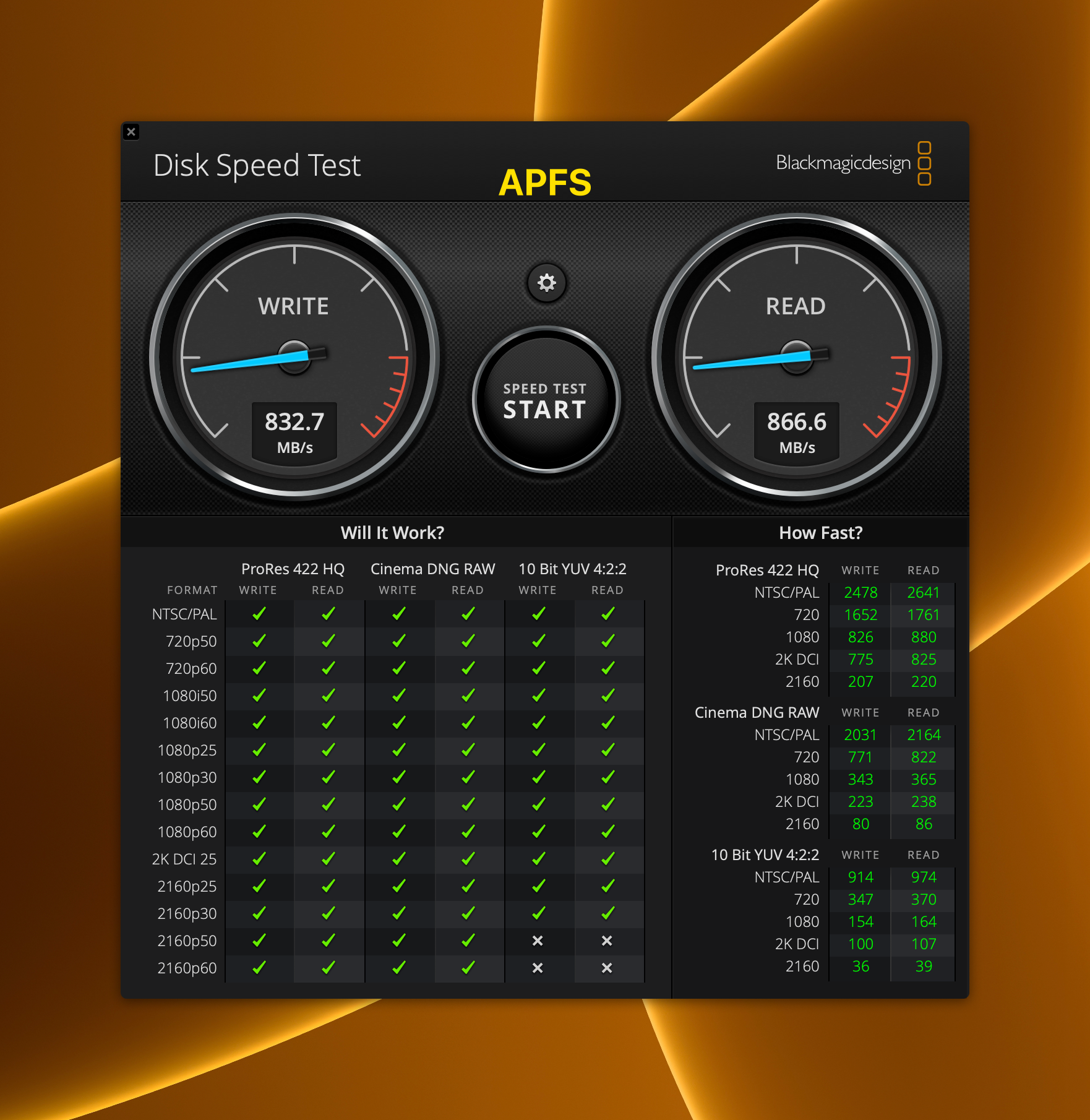

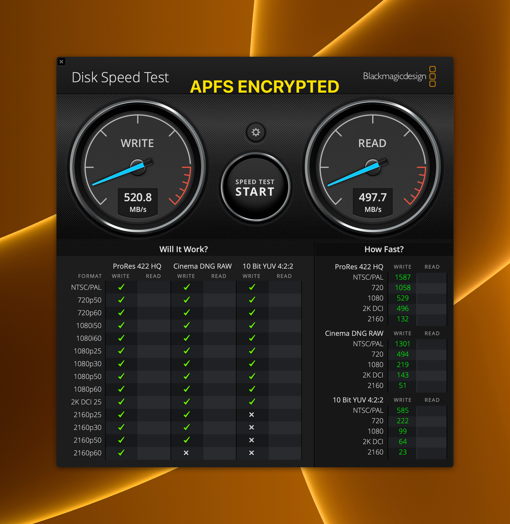

But I have another external drive (this one SSD), and right after I erase and format as encrypted APFS, the write speed is terrible—but if I erase and format as normal APFS, both the write and read speed are nearly double (see attached photos from today).
And if this is true—that APFS encryption only occurs while writing—then do encrypted APFS drives always have slow write speeds?
My past experience suggests otherwise: I had two identical disks, and formatted one as HFS+ unencrypted, the other as APFS encrypted. The APFS drive had terrible speeds, but I was able to check on the encryption percent, and once it was completed, speeds were identical. That said, I don't remember if it was originally an HFS+ drive which I converted to APFS encrypted (per the other reply)—but it's possible.
So it's still a bit of a mystery to me—and unclear why there's not simple, clear information out there on how exactly this all works.
