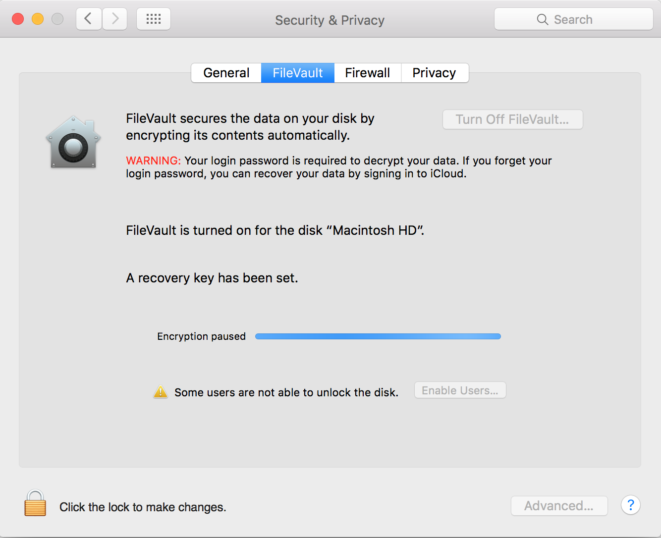

Hoping someone here can help with an answer other than reinstall OS X. I enabled FileVault due to work requirements on my work Mac running El Capitan. Now, I seem to be stuck on the Encryption Paused - connect power adapter to resume encryption. Of course, connecting it removes the "connect power adapter..." message, but encryption remains paused.
How can I get rid of this without reinstalling OS X?
Here's what I've done so far:
  • Reset NVPRAM
  • Repaired base SSD via First Aid by going through CMD + R on startup
  • Did same as above within OS X
Screenshot below is power attached.
Any advice?

Thanks. This doesn't show any progress though. Here's the code and output:
Code:
diskutil cs list | egrep 'Total|Converted|Status' | pbcopy
Code:
    Status:       Online
    |   Status:   Online
        Encryption Status:       Unlocked
        Conversion Status:       Converting
            Status:                Online
            Size (Total):          496323264512 B (496.3 GB)
Looks like maybe not converting, so, should be safe to restart the FileVault process.

Have you tried to click on the lock at the bottom left of the window?
Also, is the computer plugged in to power?
[doublepost=1456111086][/doublepost]By any chance are you using a UPS? If so, either disconnect the data cable or plug the Mac directly into the line power.
[doublepost=1456111232][/doublepost]There is a long discussion here with a number of possible solutions:
https://discussions.apple.com/thread/6602802?start=315&tstart=0

From the initial screenshot, it looks to me like File Vault wants you to click on the lock, then click on Enable Users.
I'd make sure power is connected and then try a restart.
[doublepost=1473511956][/doublepost]
That just means some users aren't able to mount the hard drive. It's normal. A privileged user has to log in before the affected user can use the machine, that's all.

A paused encryption is usually indicative of another problem. FileVault pauses the encryption if something is wrong with your disk or your power supply. What you could have done is rebooting the Mac to see whether it resumes afterwards. Then try rebooting into Recovery and using Disk Utility to unlock the disk and perform a First Aid operation on it, then restart. I have been using FileVault extensively for many years and have not run into this problem. I encourage you to try again, because disk encryption is a security asset.
I did all that you suggested and it didn't work. The only thing I could think of is that I turned it on when my laptop wasn't originally connected to a power source. When I got the message to do so I connected it but never fully resumed the encryption process. I'm not going to worry about it anymore since my rMBP is still a week old and there isn't any personal information that's stored locally that requires encrypting at this point. Plus I automatically backup documents to Google Drive and One Drive in addition to my time capsule backups being set to encrypted for extra security. I'm not sure what more I need at this point.
