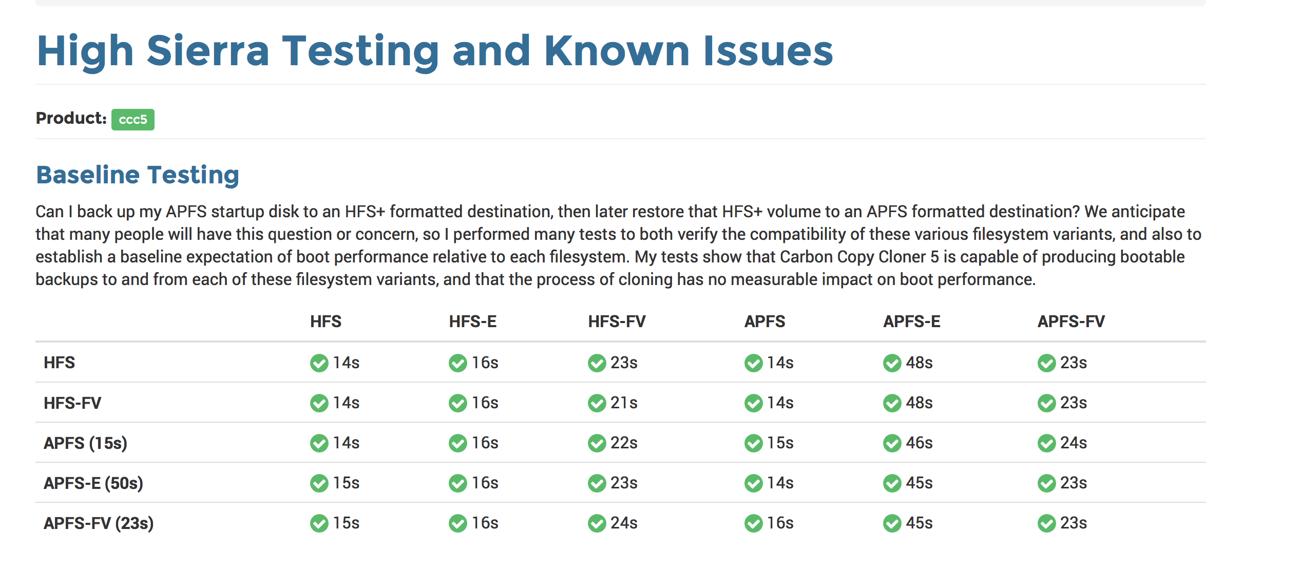

Great rundown of the performance of all the varients of formats on Carbon Copy Cloner's web site. By their measure, APFS-E (encrypted) is a LOT slower (boot times at least) than any other format option:
https://bombich.com/kb/ccc5/high-sierra-testing-and-known-issues
And do NOTE: There is a distinction between APFS-E (encrypted) and APFS-FV (File Vault)
Perhaps, its early in the morning, but I'm not understanding that chart at all.
We have HFS, HFS-FV, APFS, APFS-E and APFS-FV along both X and Y axis, I'm not sure what I'm looking at
I'd like to know the differences between APFS-E vs APFS-FV as well, which I think the OP was also trying to discern.
This is from the CCC site and explains. I don't really see the significance of the chart anyway though. I could care less about boot times. I would like to have seen some file transfer tests.
Table 1: Bootability compatibility results and boot time performance for several filesystem variants. Source filesystem is listed on the left, destination filesystems are across the top. Boot time performance of the source filesystem, where relevant, is listed in parentheses for reference.
