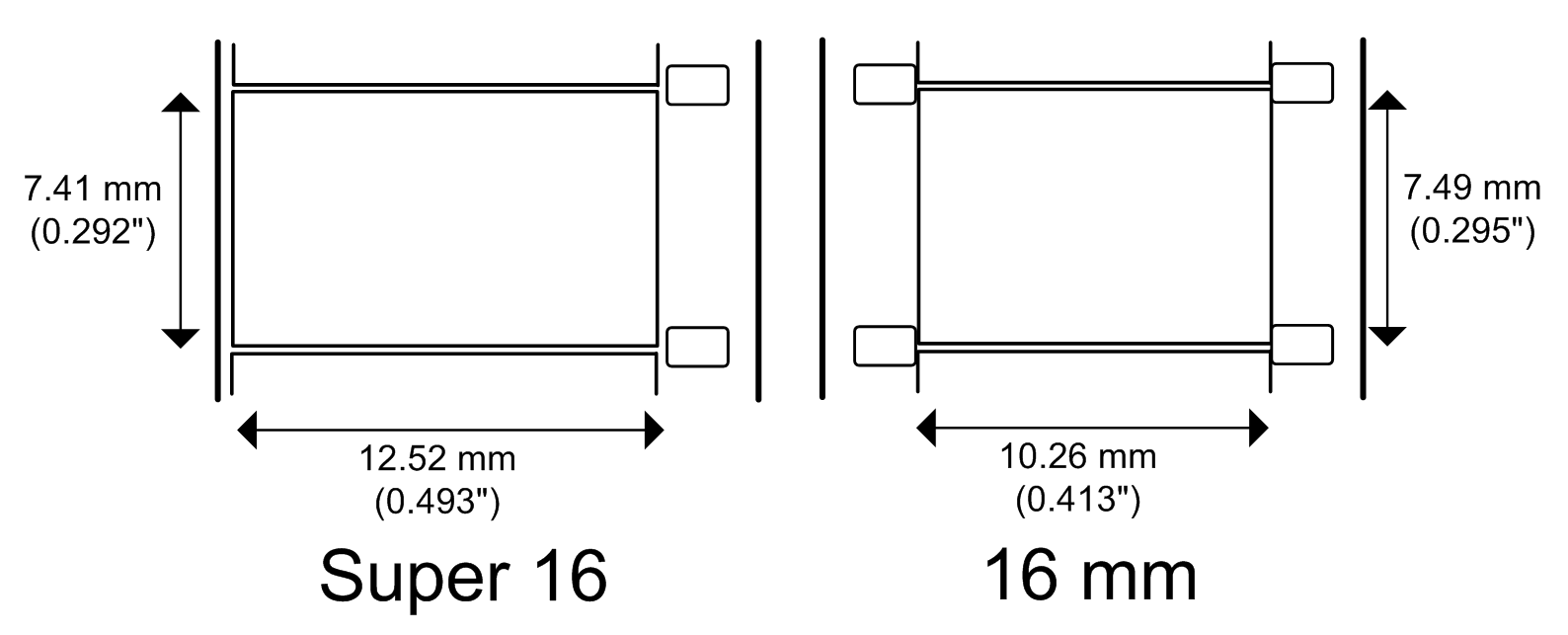

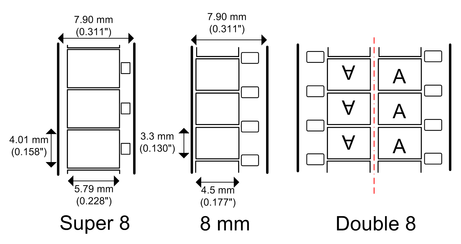

Super 8 and 16mm are larger and better formats, so if 8mm is better in HD, those will be by far better.At the very least 1080 insure the digitizing is wide enough to cover the entire 8mm frame.
Examples of 8mm digitizing can be seen here (but results vary by how good source is)
This site says "16mm film has up to 2K (1556 lines)", which is actually an estimate because there is no direct conversion between the grains in film and the pixels on digital film file (analog video has semi-direct). Some films have finer grain, cheaper films have coarse grain. Of course the finer the higher the resolution. Also a properly exposed film will gain while a underexposed will loose too.
They do not say the lines of resolution for 8mm, but reasonable to assume about 1/2, so 750 lines, roughly SD TV quality (720). Clearly 1080 is what 8mm should be digitized at.
