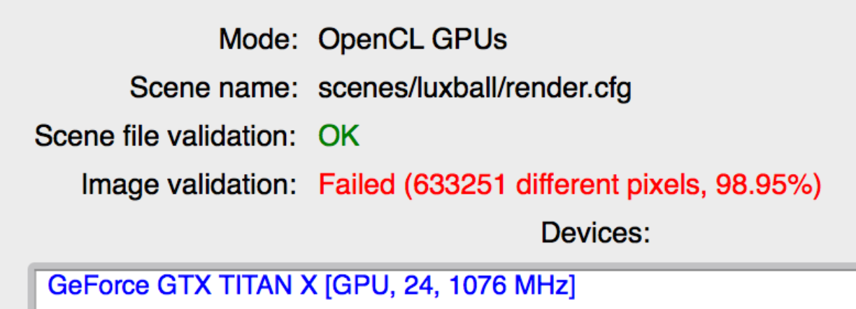

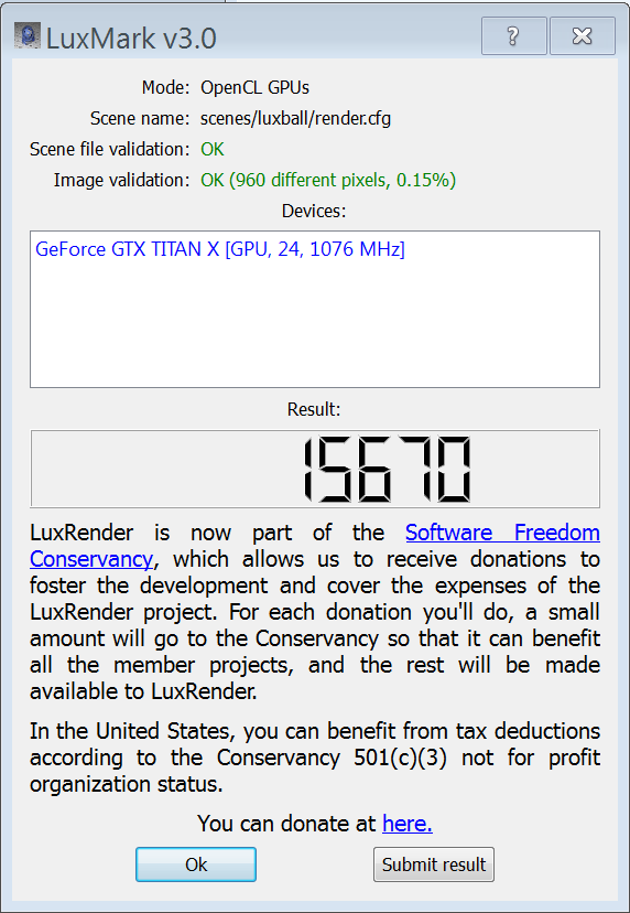

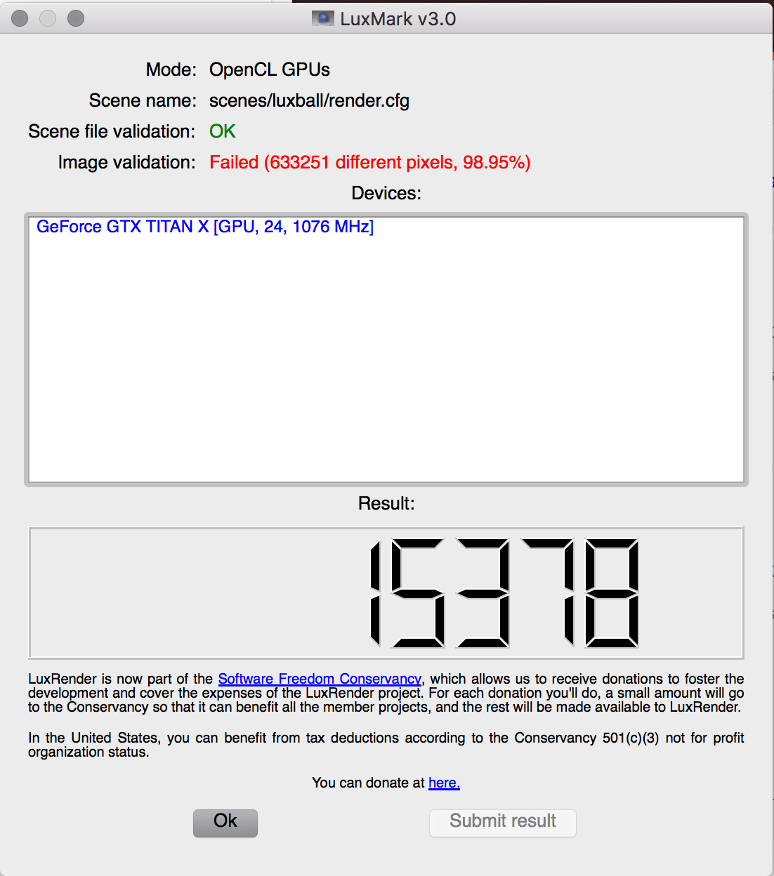

Luxmark 3 (Windows) no problems| Luxmark 3 OS X El Capitan OpenCL not good:

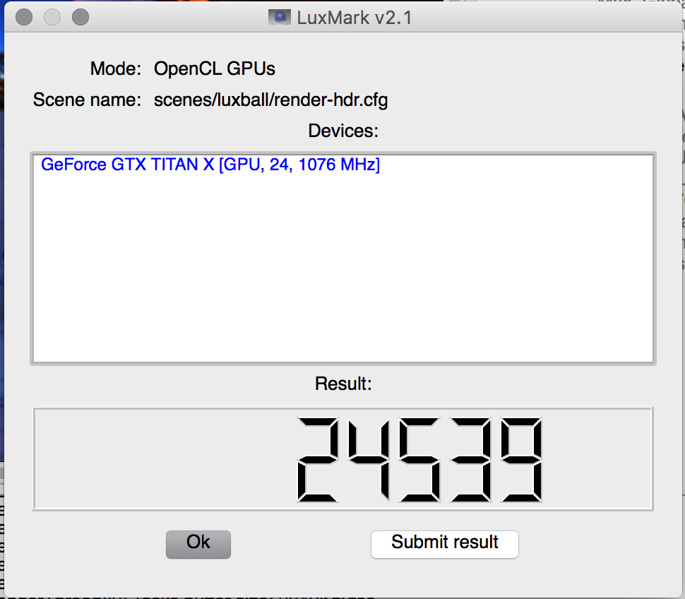

Luxmark 2.1 however on El Capitan no problems:
Is Luxmark 3 using a new OpenCL instruction set?

Luxmark 3 (Windows) no problems| Luxmark 3 OS X El Capitan Open CL not good:
View attachment 659843 View attachment 659844
Edit: I did some tests in Final Cut Pro, no problems appeared. Now then could be a bug in Luxmark 3.
The CL bugs are seen more in stability and calculation errors than in rendering performance times.

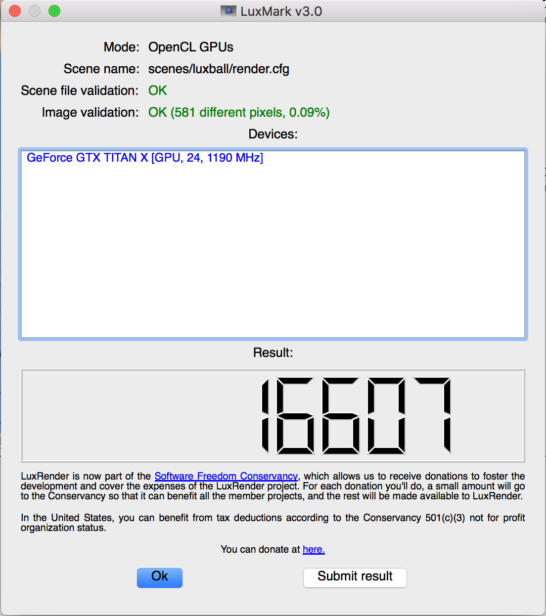

Have you tried the 10.12 driver? I just ran it without any problems on my GeForce TITAN X (i.e. no pixel errors or anything like that).
I'm currently using 10.11.6.
You're right. Using OS X 10.12 Luxmark 3 is working without any problems (only 0.09% different pixels, wow). And even faster:
I will migrate when CUDA driver and Sierra 10.12.1 are released.
