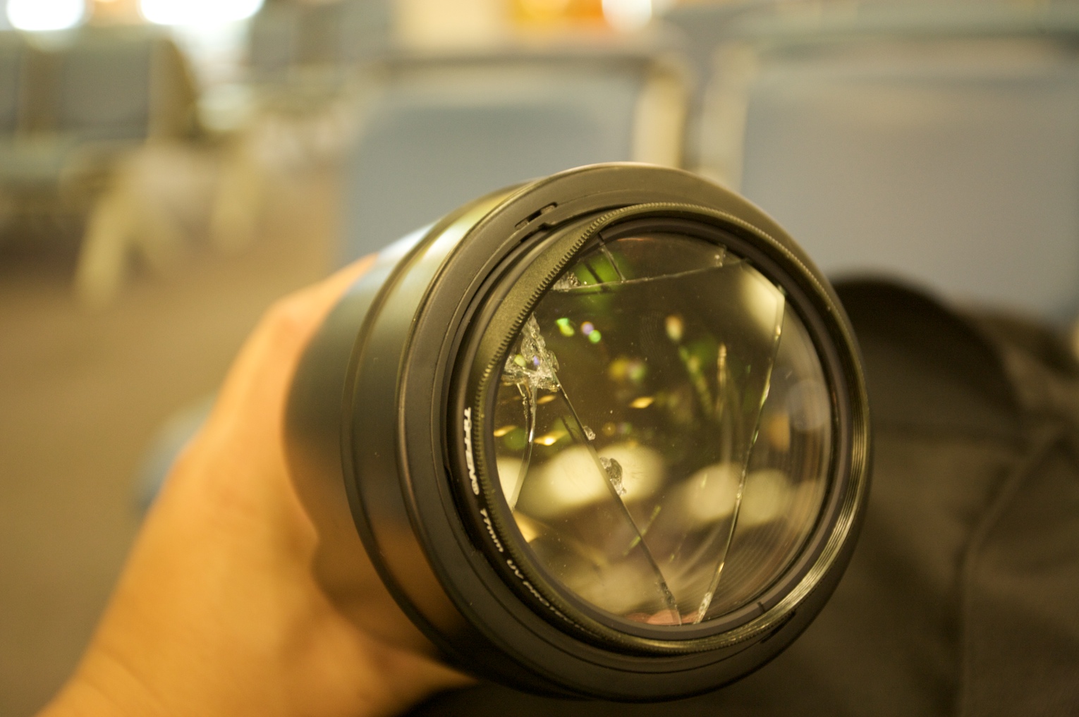

I entirely disagree about the ability for a UV filter to protect against drops.
I just had my 70-200 fall out of my bag, fall 3 feet and land on concrete. The Tiffen UV filter took the brunt of the impact, as did the lens cap.
The lens is at Canon right now getting checked out, but I think that it will be fine.
Up until that day, I was not a proponent of using a UV filter, specifically because I think that it probably degrades the image somewhat, and that any protection could be achieved with just a lens hood.
However, after that day, I am not as sure. Obviously, the lens hood was reversed in this situation.
Replacing a UV filter is a lot cheaper than fixing a lens.
Sorry about the repost on the picture for those of you who have seen it before.
