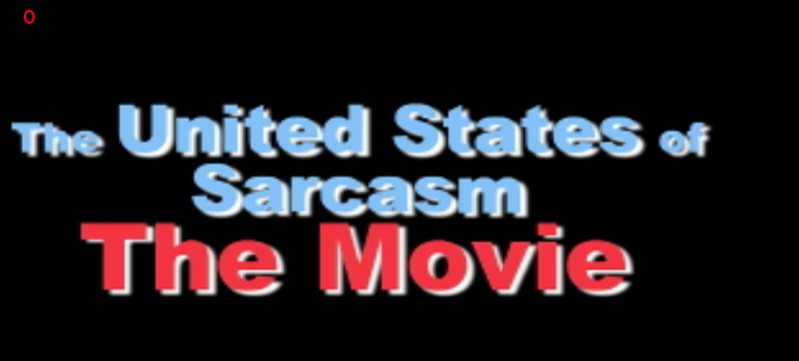

I'm looking for a way to export a movie with the original quality it was captured. When I exported using the "Export as Quicktime Movie" my text looked fuzzy (See picture with RED CIRCLE TOP LEFT).

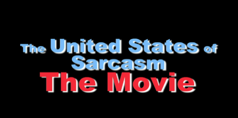

Now, I tried exporting it using "Quicktime Conversion" with "None" for Compression (which gave out a HUGE file). And here's it's pic. The text is more vibrant and NOT fuzzy.
What gives? I just want my movie in the highest quality along with with the texts (which are PNGs)

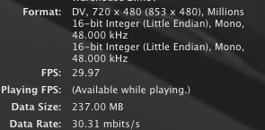

What's the source footage?
Text always takes a hit if you export it as NTSC DV because you are knocking it down to a 4:1:1 chroma subsample/interlace.
Uncompressed will always yield the best, but ProRes is great. If your are exporting it interlaced, it's going to look wonky on a freeze frame...
Thanks, I appreciate the quick response. I posted the source in the attachment pic below. (I believe it's just NTSC DV)
