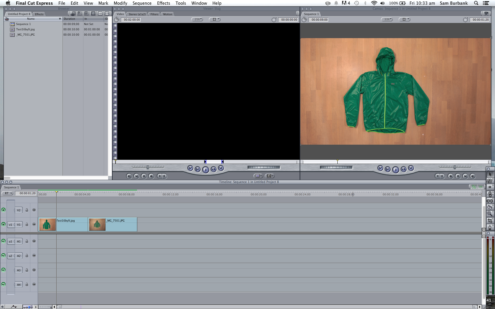

The canvas, however, immediately looked 100% better after switching the Easy Setup to HDV-Apple Intermediate Codec 1080i60 at 29.97 fps. It held the improved quality without distorting the image:
(See Attachment 3)
I'm not sure if there's any hope of having a great image quality, but at very least I would like to be able to export at the decent quality of the second screenshot without the stretching and cropping.

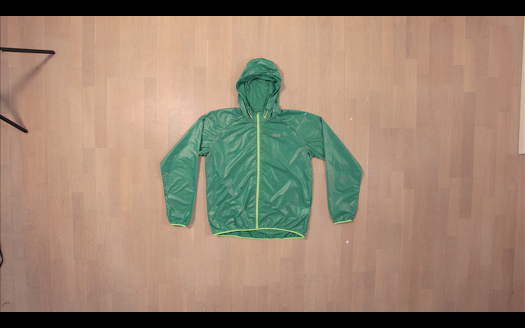

Okay I'm really kicking myself now, I found an export that I did that looks fine as far as quality goes...
I uploaded a screenshot of it along with it's details in the quicktime video viewer. I need to try to replicate this, I keep trying and quicktime says they're the same formate but the old one has a higher data rate and size for some reason... I'm exporting with everything at max.
Any help is so appreciated, thank you.

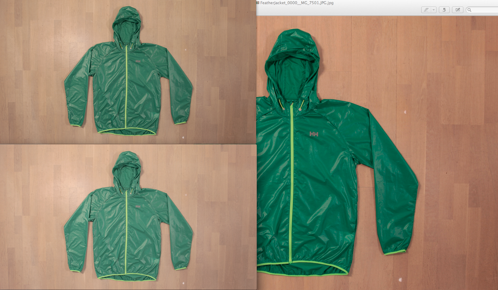

I attached a screenshot of your solution (Top), mine (Bottom), and the original JPEG (Right).
Still not quite there though, huh?
