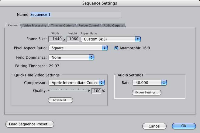

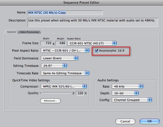

It is not really clear what you want, but I assume that you shot your video with the 4:3 aspect ratio and in FCE the footage is shown as 16:9 (widescreen)?
Is that right?
If you create a new project or sequence you can set FCE to show the footage in 4:3.
Example:

but how do you get to those windows I can't seem to bring them up
all i get are sequence presets
i did manage to solve the problem by going into Item Properties and deselecting "Anamorphic"

If you Control+Click your Sequence in the Browser, you will see a list and go to SETTINGS (or PROPERTIES).
However, the windows Spinnerlys showed will look different than yours because he is using Final Cut Pro, while you have Express. But the process is the same.
In the Express version of the SETTINGS/PROP window will look like a table/chart. With a bunch of terms on the left-sidebar.
On the left handside find the word ANAMORPHIC. In that row, right next to ANAMORPHIC, there is either NOTHING or a CHECK MARK. Either way, click that area and either the check mark should go away or it should appear.

settings
what you just described is how i got the original problem solved (by unchecking amamorphic but i still can't find any other setting options
but u may be right that maybe those windows that he displayed here maybe i don't have in express
