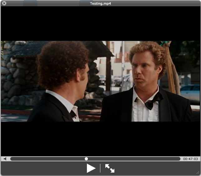

So here I have this movie file:
I have another one of the same movie, except in the AVI format. Now theres a long long long story. As you can see, there are black bars on top and on the bottom of the video, which werent there with the AVI format in the beginning, I would like to remove them. Is there such feature in Final Cut Express where I can crop out the top and bottom bars. Then in my video compression application (iSquint) stretch the dimensions to 640x480? The actual video here is 664 x 268.
Pretty much what I am asking, is if I can crop out the black parts using iMovie 09, or iMovie HD, OR even Final Cut express. and what I mean by cropping, is to get the video from its current res 640x480, down to 664 x 268 where the actual video is, then stretch is to 640x480 with the bars.

For example
usually when I convert an AVI video file with those same exact dimensions to MP4 with 640x480, it will stretch the video, which I don't mind. Final Cut Express ADDED those blacks bars ITS SELF. They weren't part of the video.

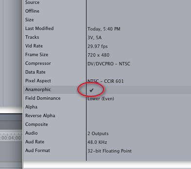

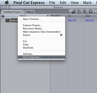

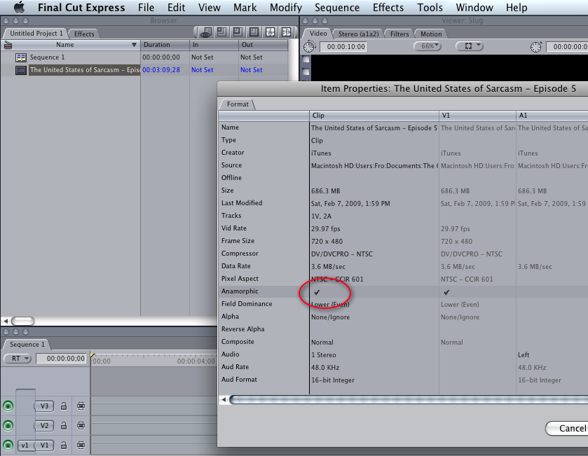

1. Import your original video
2. Now, RIGHT-CLICK on movie and ITEM PROPERTIES
3. Next, check the box for ANAMORPHIC (as shown in the pictures).
Now do the same for the SEQUENCE 1 item (shown in the pictures).
4. Drag the ORIGINAL video from the browser to the timeline.
5. Export the video using Quicktime Conversion, and go to the OPTIONS.
6. And change the SIZE under the VIDEO heading and go to custom.
Hope this works, if not, I don't know what else. Maybe someone else can help.
