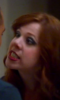

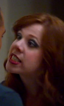

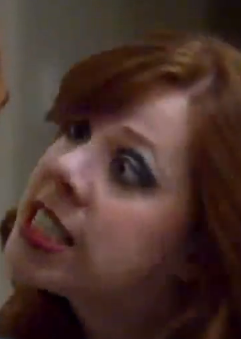

ive attached screen shot of the various stages of work/compression. the first shot is of the pixelisation I referred to when viewing the videos on youtube's HD 720p setting. the second shot is taken while working on the video in imovies.

(For the record, I wouldn't call what's in those pictures "pixelation". "Smearing" or "mushiness" are better. Might seem pedantic, but it's relevant.)
Where is the middle work flow shot. The one you exported from iMovie?
Also, I notice the one from YT has the ladies face much larger. It's as if you enlarged the result from YT. If so, then yes, I'd expect a degraded picture. I know safari will enlarge video like that when you tell it to increase the size of a page via command-+.
