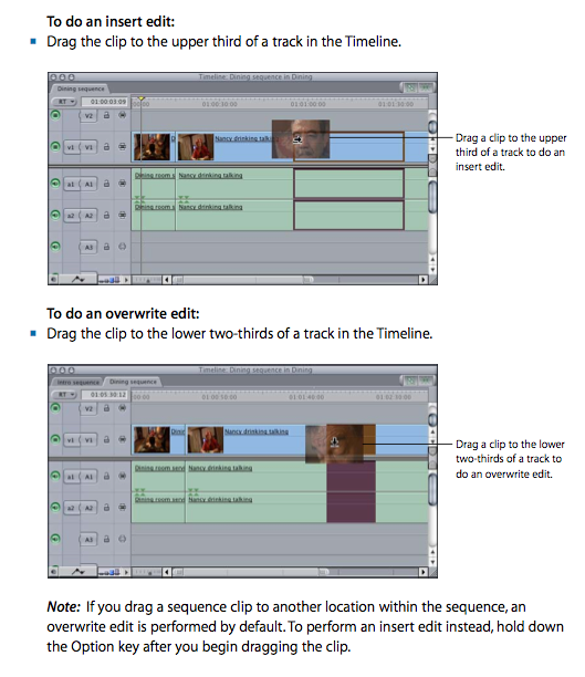

Take a look at FCE > Menu Bar > Help > FCE Manual > page 355 (Doing Simple Insert and Overwrite Edits in the Timeline):

If I drag a video from the browser to splice into the timeline then it's fine. There's two arrows, a right one representing the insert edit and a little lower sits the overwrite edit area.
The problem is, I want to drag clips that are already in my timeline to insert edit between other clips. When I try to do this there is no right pointing arrow, only an arrow that points down representing the overwrite edit. If i hover over the upper third or the lower two thirds it's always the overwrite arrow.
Why is this and how can i insert edit instead? 😕
Select the clip you want to move, drag it, press and hold down the Option/Alt key and release the clip where you want if the icon changes to an arrow pointing to the right.
