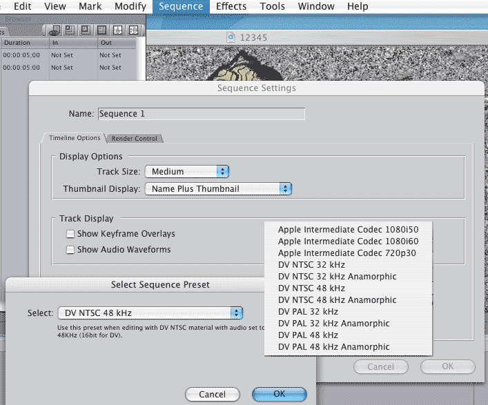

Is this where the sequence project options are set? Also, when I view file information>More Info:>Codecs:Video is the setting. We tried exporting the test clip at 1920x1080HD, the output was still blurry. I obviously need to take a class or read more about this - any suggestions?
O.K. this is an addendum to the previous paragraph. Thanks for all your help. We changed both the output files from ArcScene and the input "sequence settings" for the project. Viola! Beautiful. The video is crisp and clean and resolution is lower. Happiness and light. Thank you for taking the time to respond.
Great to hear! Just a future note for the sequence settings, you often have to set the projects settings as well, especially if you are dealing with multiple sources of different resolution. The easiest way to do this is to start a new project, and then go to The "Final Cut Express" menu and select "Easy setup". Then you set it to what you want. This will make all new sequences be set to this format.
