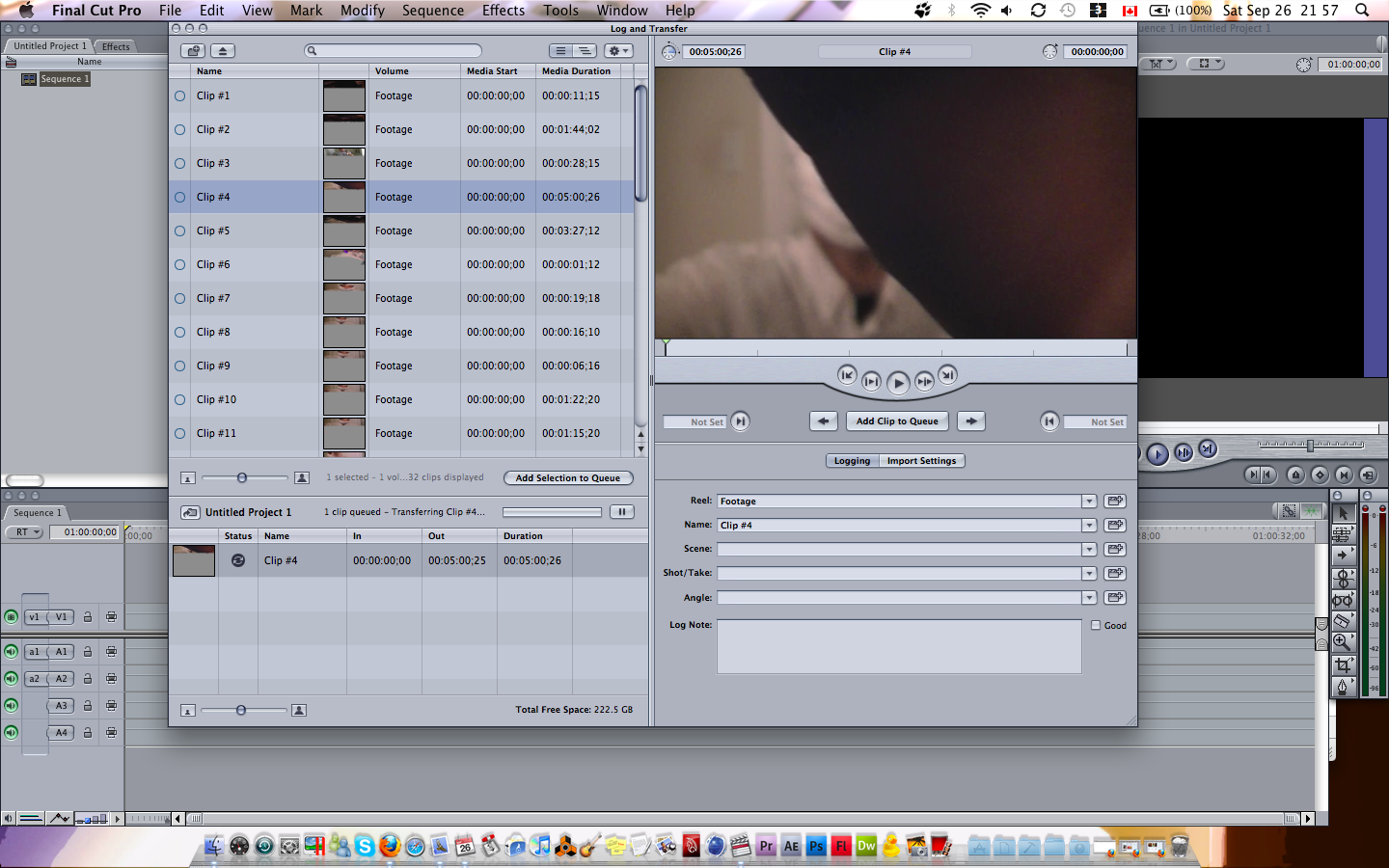

I've attached a screenshot of my L&T window for reference.
Notice how in the list of footage, the thumbnail is screwed up, only showing the very top of the frame.
However, on the right where it shows the video, the frame is totally fine and I can play the video just fine as well.
But after importing (and I've only ever been able to successfully import one clip, it usually crashes, sometimes even right as it begins converting the first clip), the video looks like the thumbnail, with only the very top of the frame intact.
