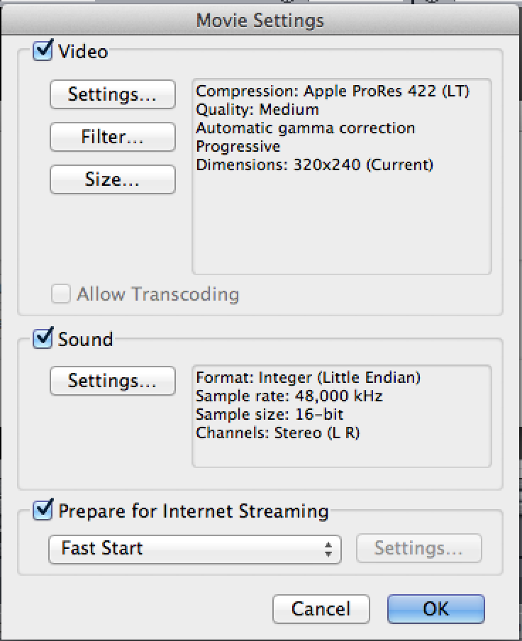

Hi everyone, I have a problem with FCP7. I made some videos with my iPhone 6, but after editing them on FCP7 I can export them only at a resolution of 320x240. Because I converted them into prores 422 LT format I thought the problem was my macbook pro, maybe there was not enough space, and it could have been that I was editing in the offline rt mode.
Thus, I did a test on my iMac 2009 (1000gb) and this time resolution of the exported video was 646x272 (272 because I captured the videos in 16:9). Better than before but not still the resolution that I expected. What error am I making?

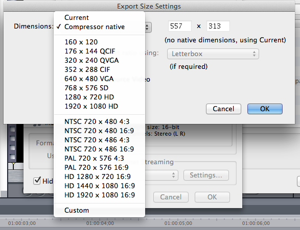

How are you trying to export from FCP 7? If you chose Export->QT Conversion you should get a drop down menu with common sizes and the ability to manually enter a custom size. With that being said, using Compressor will get you much more control over your export than using FCP.

I tried a lot of different settings (prores, h.264, hd tv) but nothing seems to work. Instead, if I edit iPhone videos on iMovie the final product quality is perfect.

As you can see from your strangely oversized screenshot, the upper section shows the resolution as 320 x 240 and names it as CURRENT one.
What happens if you click the SIZE button and adjust accordingly?

By the way, if I modify the size and select 1920 x 1080 HD, when I export the project the final result is absolutely not HD and it is very similar to the result I get by selecting the size "current".

Is that image you posted (Movie Settings Menu) part of the export from FCP?
When it says "current" next to the 320x240 it leads me to believe that you're editing in a 320x240 timeline, which leads me to believe the footage you're bringing in to FCP is 320x240 to begin with.

P.S. Yes, the image I posted is part of the export from FCP7.
yes, "current" seems to imdicate, that your timeline is in 320x240.
i'm not working on fcp7 anymore either, but if memory serves right, you can look up the clip sizes in your project window (scroll to the right) they should have the resolution of your iphone-videos (1920x1080).
same goes for the timeline (in your case 320x240). there's some menu, where you can set the size of your project (try something like rightclicking the project -> project settings ). you might have to scale up your clips again after resizing the timeline (doublecklick on one clip in the timeline, scale, and then copy and paste the scale property to all other clips).

Final Cut will usually automatically determine the scale of your timeline by the footage you place into it. So it sounds like your files being 320x240 is happening before FCP even comes into the equation.
