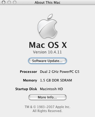

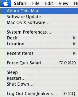

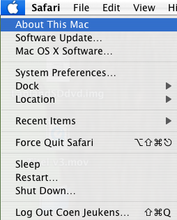

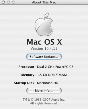

To check your Mac.
  1. Go to the :apple: logo in the top left corner.
  2. Press about this Mac (see picture)
  3. A screen will show the "muscle" of your Mac (see picture)
In my case I have a G5 (PowerPC) running at 2 GHz. And I have two of them (dual). My memory is 1.5 Gb.
I use FCP. Just like you, my camera produces HDV files.
I import the files via a firewire cable. I do NOT transcode to a processor less intensive format.
Performance is great. Only the final product rendering may take up to 5 times the length of the video (coffee is great 😉).
