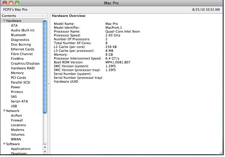

I guess you have a Mac Pro, as PowerMacs can't run Mac OS X 10.6.x. What specific Mac Pro?
To find out, look for the Model Identifier here:
Do you use the 1Gbit/s or the 10Gbit/s connection and which specific hardware do you use to connect to that device?

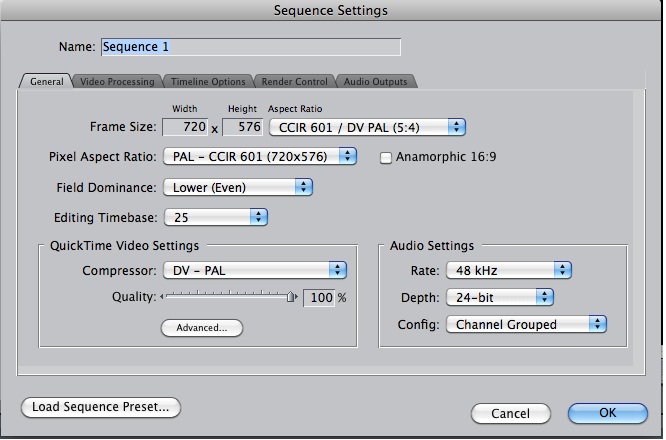

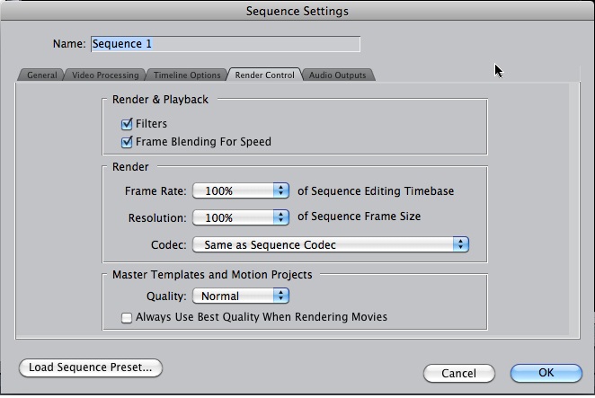

What are your sequence and clip settings in Final Cut Pro?

That is really strange, as you use the DV codec, which has an average data rate of 3.125 MB/s, thus even a USB HDD could work without problems. Does the manufacturer of the Isilon have any firmware updates due to Mac OS X 10.6.4?
