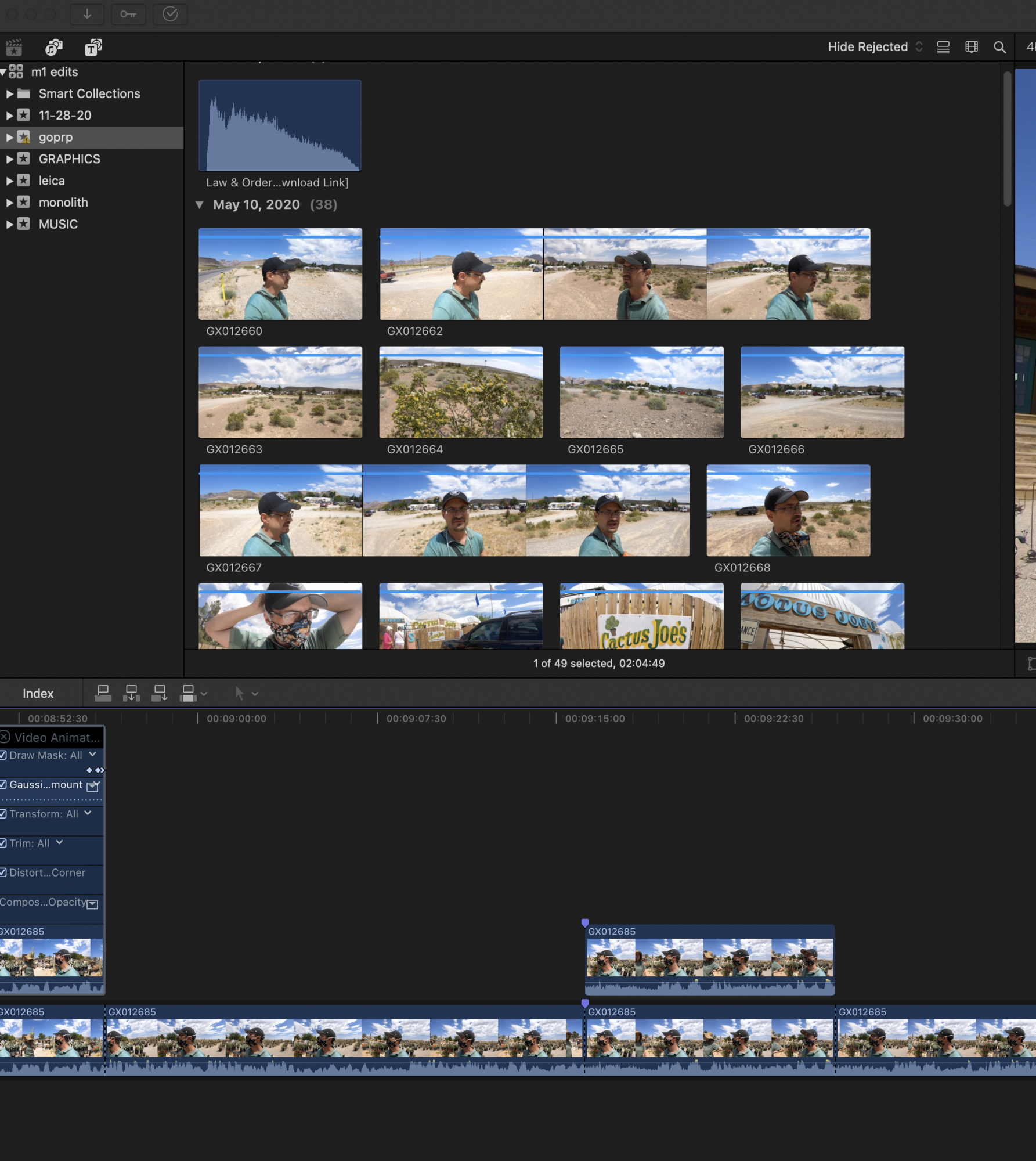

Thanks for the reply, does that triangle only appear in a specific view type? Here is what I am seeing, I work with the clips in this view.
This is FCPX 10.5
