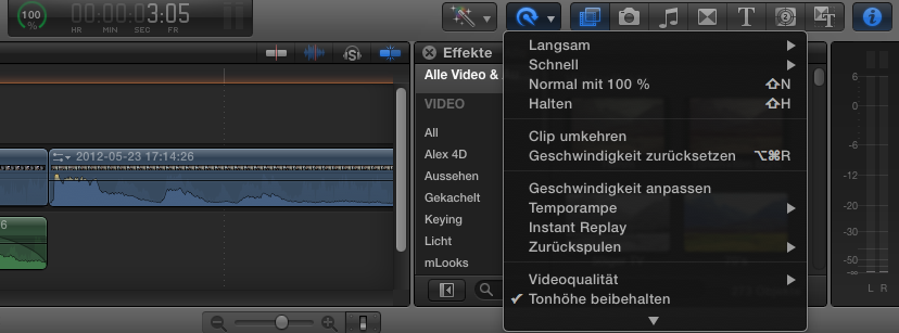

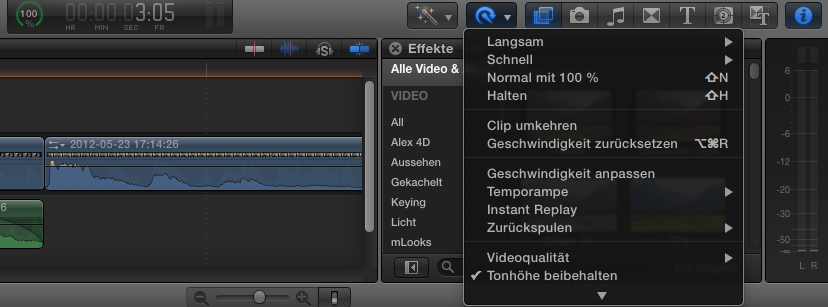

Two more things I want to add to that:
1. The default way FCPX will slow down your footage is by copying frames. That can look very choppy and not as smooth as you want to. Be sure to change that into "Optical Flow" and make it look much smoother. To do that, mark the clip you slowed down, and click at the Retime-Button above your timeline. The dropdown menu will look like this, but translated from German to English 😉:
Then from the submenu "Video quality" choose "Optical Flow". This will be slower but give you way better results.
