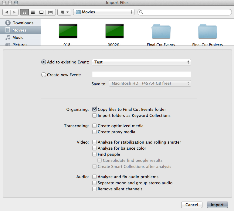

Secondly, when i try to import movies i have this abnormally large import window that covers up most of the thumbnails that i'd be searching through. This is what it looks like
This isn't normal right? How can i change this?

You could either resize the window, below is a screenshot of how to do this in Mac OS X 10.6 Snow Leopard, but Mac OS X 10.7 Lion offers all sides to be used to resize a window.
And you can also use List View (CMD+2) instead of Icon View (CMD+1) and QuickLook (Spacebar) to browse the clips, though .mts clips will probably not imported.
PS: The window is that big because of all the import options.

There's gotta be something i'm missing here. I read the link you provided and you can indeed mess around with resizing, but the resizing in this situation is completely counterproductive to what i'm trying to do. When i resize (to make it so i can see more files) all it does is decrease the size of the file window and leave the "options" window the same size or bigger. This, besides the mts issue, is the biggest thing i hate about final cut. Especially when scrolling through tons and tons of files, 1 row at a time is just a pain. Is there a way i could just copy and paste into an event? There needs to be an option to hide the settings for a bigger view of the actual files. This is how it looks when i resize my window
I missed your signature, thus I didn't thought about the resolution, and as you are limited to 1280 x 800 pixel, you can't have a bigger file view than in your first post.
You could however use Column View (CMD+3) and have a preview of the file on the right side and use your arrow keys to navigate the files.
