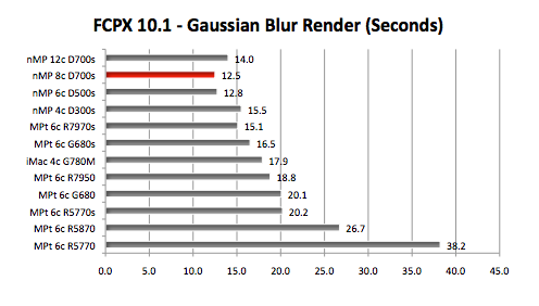

Currently the fastest GPU for FCP X is dual 280x - even beats the dual D700 slightly. I don't know if there are any 980 benchmarks int he wild, but it wont be much better than the 780. It'll be better than the 770 shown here but probably wont approach the 280x (I'm guessing, I know).
AMD has better compute performance, which is likely a big part of it, but there's also driver support. Another user on this forum says their 290x isn't doing so well -- but that may be because it is unflashed and only running at PCIe 1.0 (4GBps).

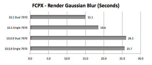

Having 2 cards is better than having one to some extent, as seen here:
However, not by a whole lot.
I would expect that if the 290x ends up being flashed to do 2.0 and has driver support that It'll edge out the 280x/D700 but who knows by how much, may not justify the price.
If I were you I'd buy an MSI 280x or two, flash them, put them in a cMP along with some SSD and have a killer machine for half the cost of the nMP with better performance.
