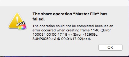

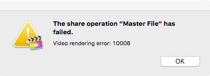

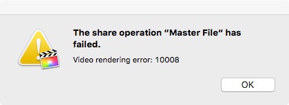

Anyway, I am having problem when exporting my first video project with Final Cut Pro X (FCPx). I did have a problem with iMovie, too. Oddly, I never have problem with Filmora or some of my older projects. I am not sure what I am doing.
Here is the error.

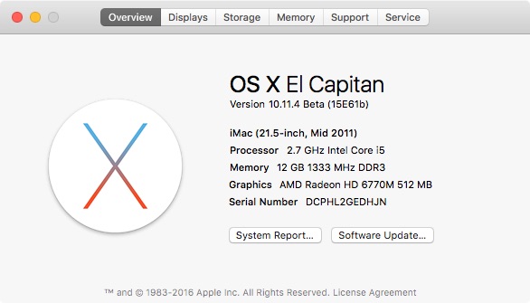

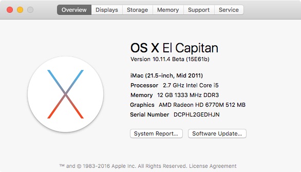

Here is about my iMac.

Also is there any particular reason you are running a beta version of El Capitan? What version of FCPX are you running?

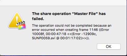

[doublepost=1458099846][/doublepost]When I choose that specific clip that is causing the problem, this is what I got.
