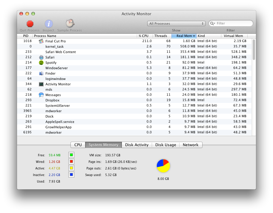

Alright so I've been working for a little while today, watching my activity monitor.
I restarted my computer, deleted/moved some projects and started editing. I'm still using my usb setup for the moment, but I still can't figure out why I'm getting page outs when I have inactive memory that could be utilized. I attached a screen capture to show this. If FCPX uses inactive ram, what differentiates it from active? Thats bizarre if that is the case.
Also, what is the reason for the wired and active memory down at the bottom not equal to the sum of all the processes? Is that including whatever the video card (integrated graphics) tries to utilize?
One last question, if I did get an SSD for my main drive, wouldn't that still be the better option to use instead of the hard disk drive attached in my optical bay? I know the system will be utilizing it, but won't the speed more than compensate for the slow down caused by the OS? What's the major drawback? I'd obviously only have on project open on that drive at a time and then transfer the ones I'm not using to the hard disk.

Most likely FCP is using the inactive RAM. I go a lot of times with FCP only using a few GB while 16 or more GB is sitting inactive. I don't think anything is wrong here.
Well I'll take a screen shot but usually the breakdown will be as follows:
Inactive 4GB
FCPX 4.2GB
iTunes 400MB
Safari 200
etc.
etc.
