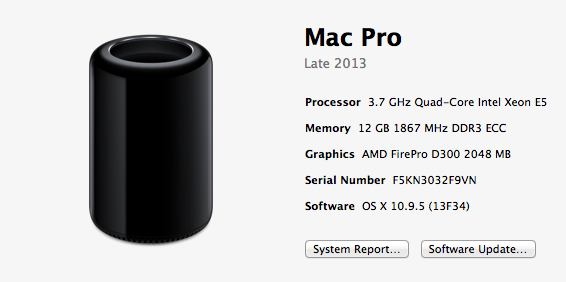

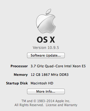

Hello - I work for a company that recently bought a Mac Pro to mainly edit videos. As I have began editing on it, it has gotten progressively slow. To the point where it has trouble playing back simple edits. I am not great with computer specs and such, but I believe it should be running much more efficiently than it is currently.
Attached is what I am operating with.
I have tried turning off background render and quite a few other suggestions as far as speeding up the process.

Well, I'm not sure if it's the root issue, but a LaCie Dual Thunderbolt 2 with spinning drives won't be terribly fast, definitely slower than the internal storage. A lot of that depends on what kind of media you're using though.
I'm not sure why you're talking about Firewire and USB connections with a Thunderbolt drive as well. Just plug it in with Thunderbolt. I don't know if that should make a huge difference, but if you haven't plugged in the drive with a USB 3.0 cable that might not be the best, and there are enough Thunderbolt ports on the thing you might as well use Thunderbolt.
What kind of footage are you editing? How much is there? It could just be that if you're working from the external drive you'll need something faster. The internal drive is about twice as fast as the LaCie, so maybe try pulling a project to the internal drive and see if your problems go away.

I agree that your memory may be a limiting factor on a larger project. Not sure how long your videos are, but 12 GB can be used up fairly quickly. Check your memory usage and 'pressure' using the 'Activity Monitor' or something like iStat.

12GB isn't a lot for video editing but it should be enough for modest projects.
I have run basic FCP X performance tests on a similar nMP vs my top-spec iMac. The nMP is a little faster for some things, the iMac is faster for H.264 export. They are both capable machines for video editing, and you shouldn't see major performance problems.

For the OP I would increase the system RAM, check the Lacie Drive's speed to make sure that's not the bottle neck, and optimise the media if it's not in ProRes already.
