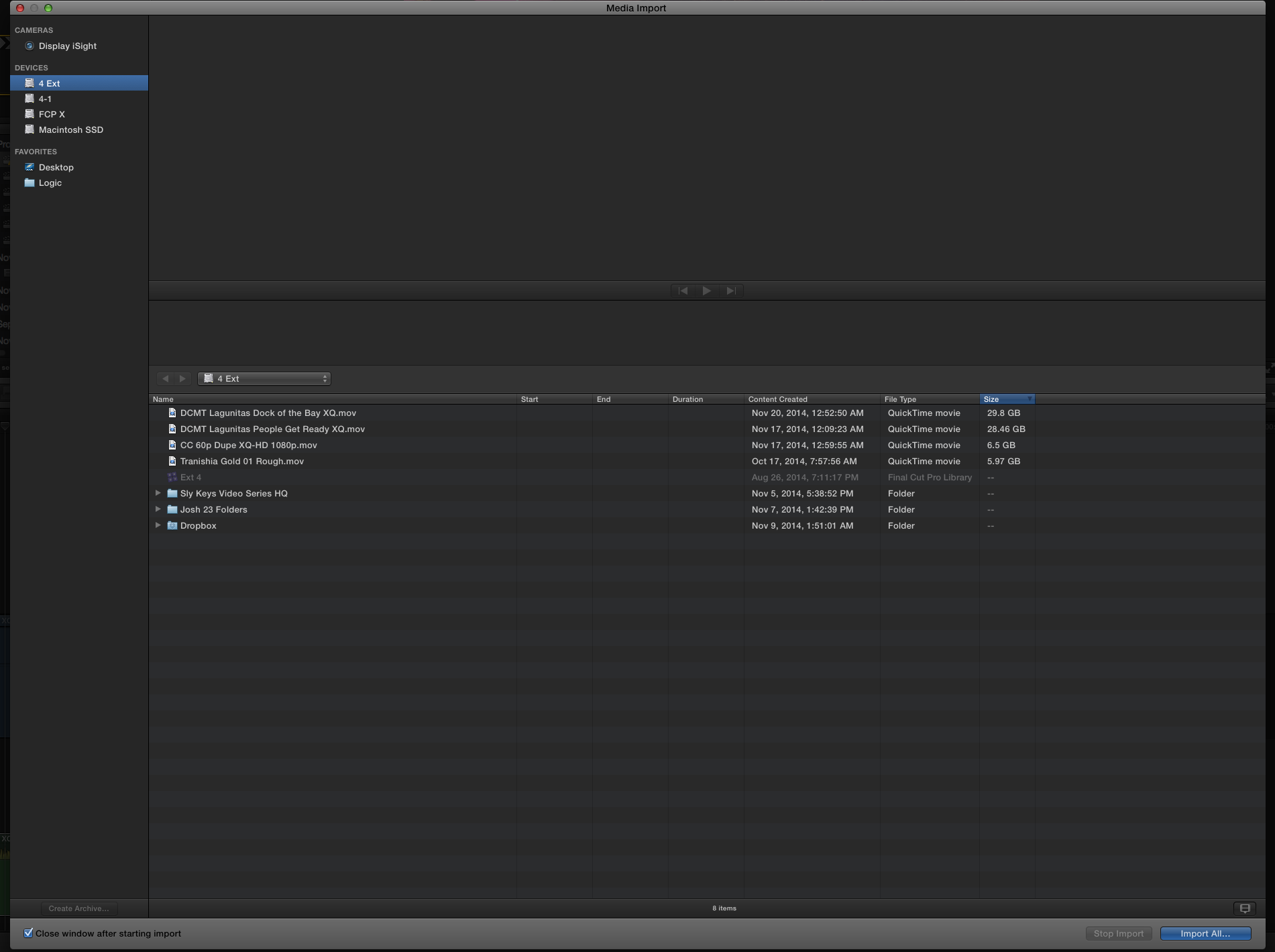

When you Command + I the window should look something like this
Post a screen shot of what yours looks like. (Shift Command 3 or Shift Command 4 to take a portion of the screen)

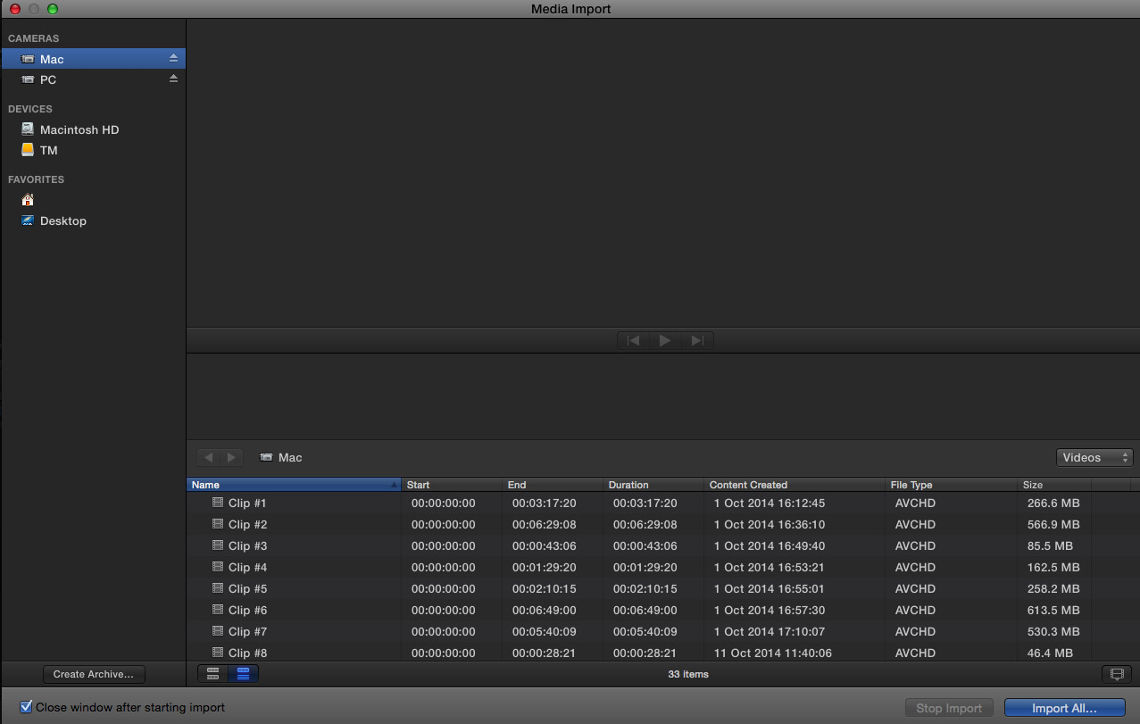

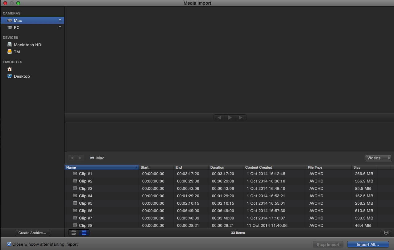

Zwhaler. Here's a screenshot of when I press CMD+I
Is 'TM' the drive in question? (Or is there a missing drive?) What happens when you click on TM on the left there?

My external has 3 partitions. PC, Mac and TM which is for Time Machine.
