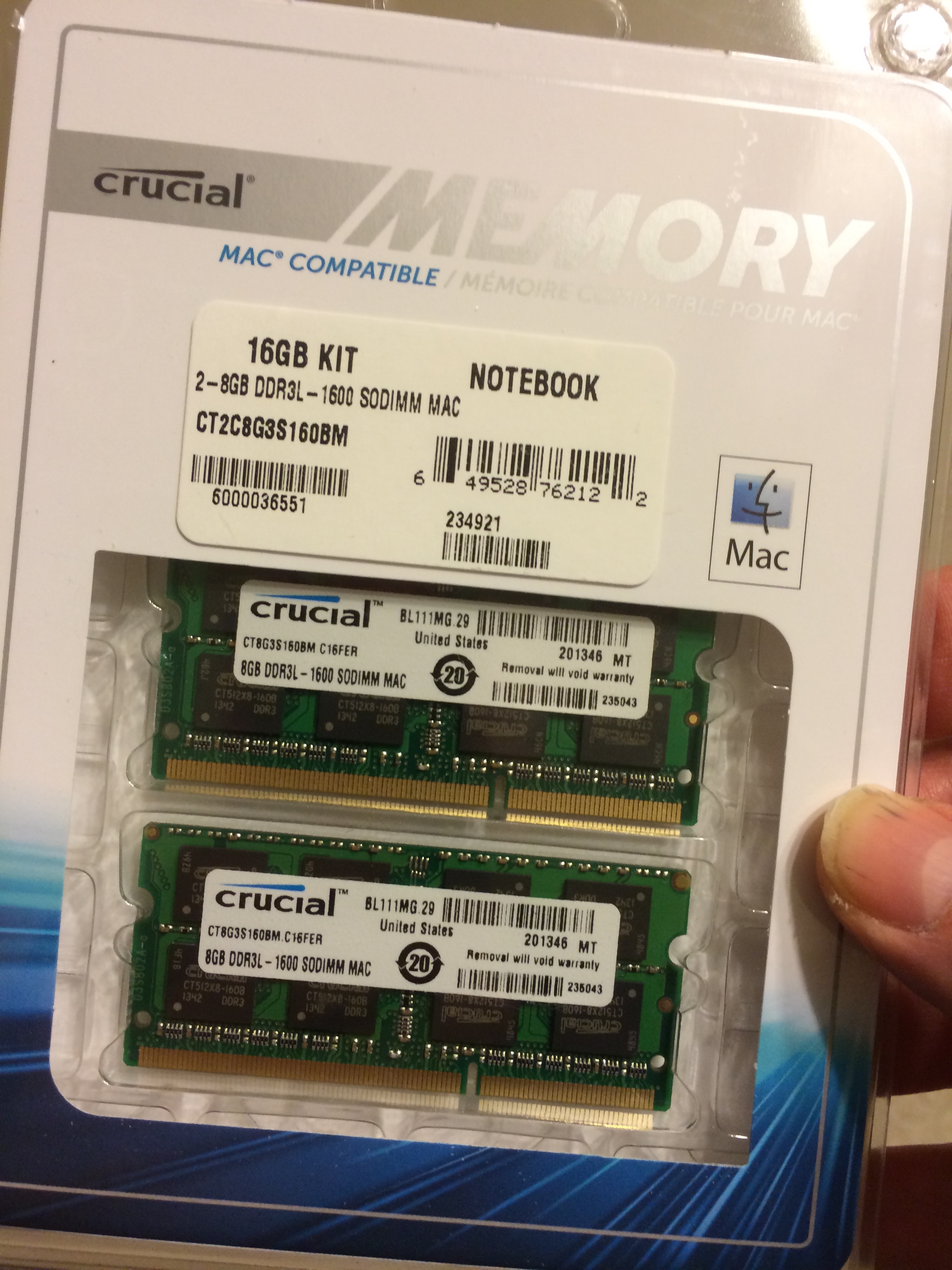

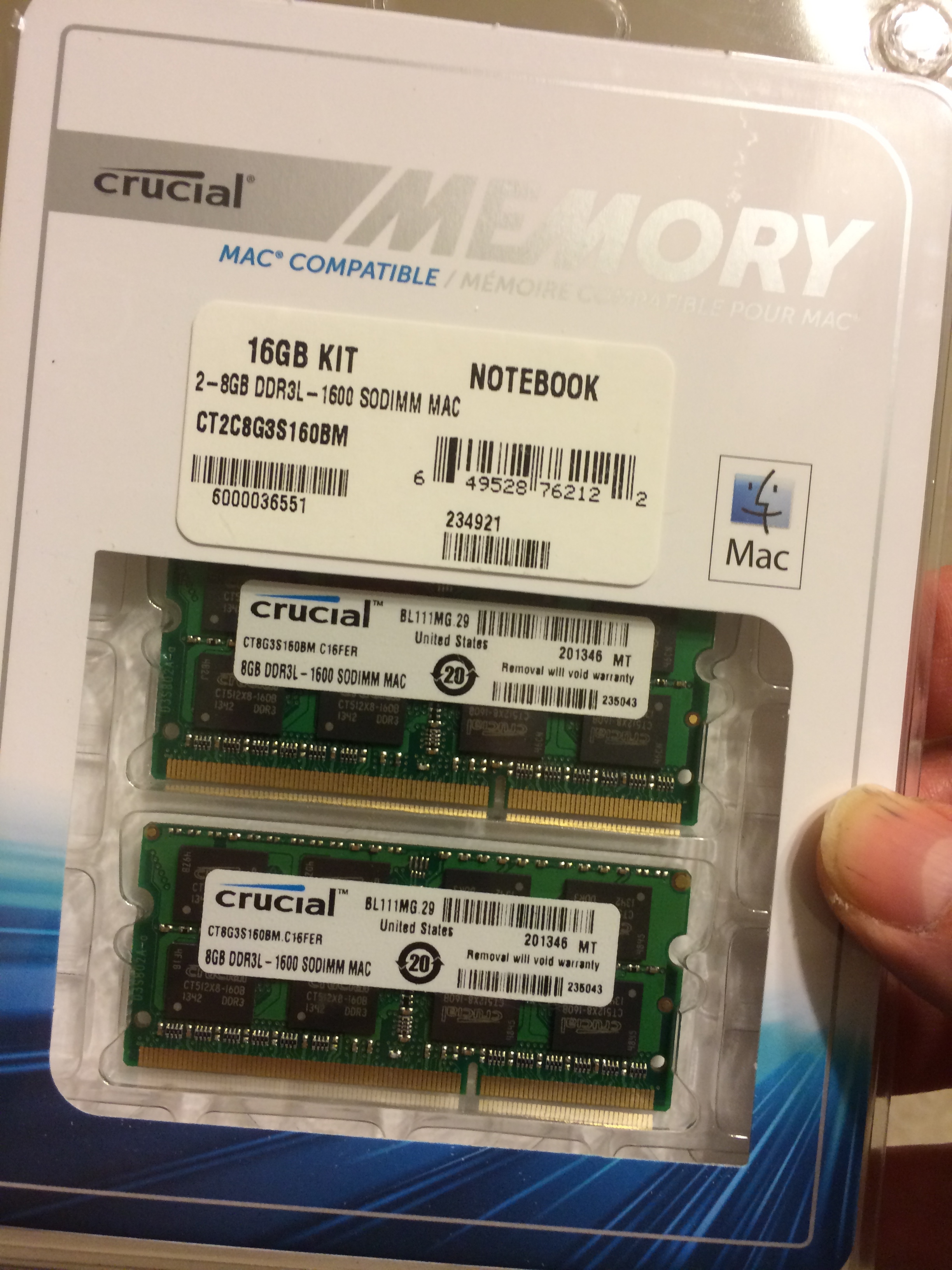

Here is the package that came from Amazon for $139. Looks like the right RAM. Will find out next week when I install it.

Happy to hear your ram is installed and working well. If I understood your initial post, the ram you purchased was Crucial Ram from Amazon? If so is this the part number you received CT2K8G3S160BM? Did the ram indicate where it was made,USA or China...some reviews I read indicated the China modules seemed to be a bit better fit than the USA. I do understand the Crucial modules are a bit tight,according to Crucial they require 30-40 pounds of force to properly seat the modules.
The part number on the RAM I got from Amazon is CT2C8G3S160BM. It's made in the United States. Will find out next week how well it fits.

My part number is CT2C8G3S160BM. I'm not sure if it was made in China or USA (it probably said so on the module sticker but that's tucked away inside my computer now).
One of the chips went right in and seated fine. The second one really didn't want to go — I could see it wasn't all the way in, but I couldn't pull it out easier either. So I just gave it a good hard push and it clicked into place.
