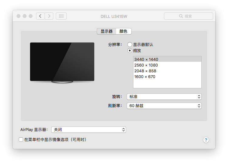

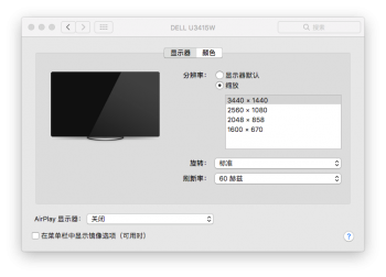

My setup works perfectly fine at 60Hz on the native resolution of 3440*1440. With no cutting in and out.
But I found that if the power supply is not enough, there will be some problem with the screen. For example if I cut the AC power, the 3415w will go down at the same time.
