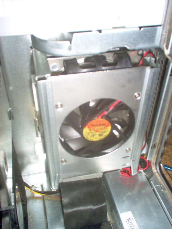

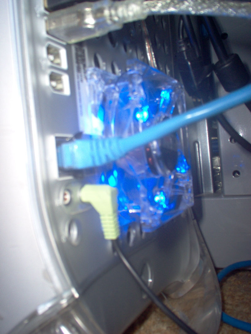

Today, after spending 13 bucks at my local computer shop on a HD cooler fan (80x80x15 fan), an 80mm fan to mount on the back and suck hot air out and a tube of much better thermal paste. the stuff I used before was 25% silver and the new stuff is 99%. the MDD is already so loud that I can't even hear the 2 new fans. I put the hard drive fan right in front of the HD by the heatsink and turned the fan around to blow at the heatsink instead of the HD.
Temp on the cpu board now.... 49.4c and stable there!@# not bad for 13 bucks and a very small amount of effort. most of all when you consider this thing ran as high as 59c when I first got it.

the hard drive fan blows 32 CFM of air directly on the heatsink at 3200rpm so that helps a lot also. the fan on the back is only a 2000rpm and blows 22 CFM but the air it blows out feels quite warm so its doing its job. both are very quiet.
